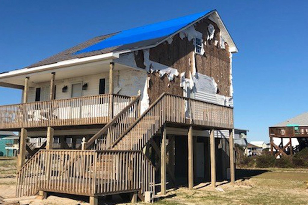

In the event of a severe storm, a durable roof may help protect against water intrusion at the most vulnerable area of a home. Under strong storm conditions, roof leaks can cause costly repairs and put belongings inside at risk of water damage.

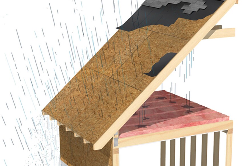

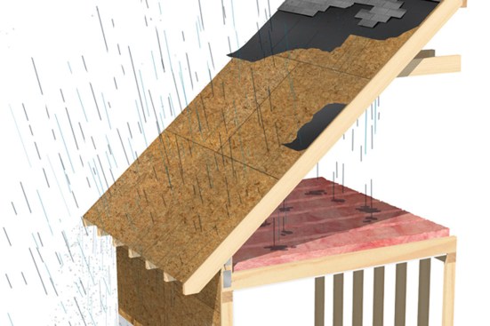

Traditional roof decks may be constructed with oriented strand board (OSB) or plywood panels as the structural sheathing layer. Next, 15- to 30-pound felt (per local code) may be installed on top of the panels to repel water from the wood substrate. Lastly, a roof covering, such as shingles, is attached. In the event the covering, and likely the felt, is blown away, this method can leave vulnerable panel seams exposed, which can occur during construction or in a high-wind event.

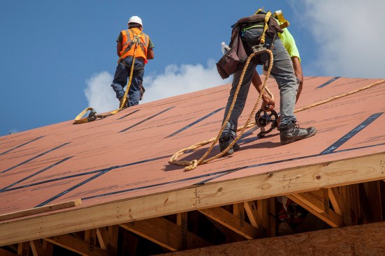

But a sealed roof deck, such as a ZIP System Roof Assembly, which is made of engineered wood panels with an integrated, water-resistive barrier and advanced acrylic tape, provides a secondary, continuous water-resistive barrier on a roof deck that helps prevent water intrusion at panel seams.
A sealed roof deck helps protect the integrity of the structure by sheltering the interior from water damage in the event the roof deck is exposed. Building sealed roof decks as part of new construction projects has benefits for builders, too. Sealed roof decks can help achieve a quick rough dry-in to help interior crews start sooner and help protect interiors from water damage while a roof may be exposed before cladding.
