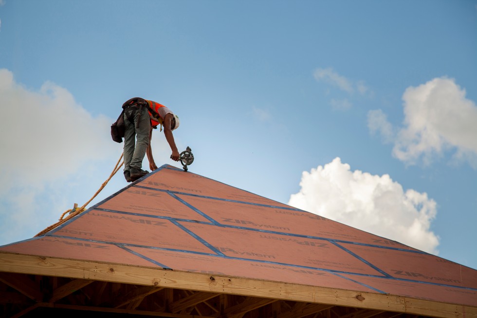

Sealed roof decks built with integrated sheathing and tape can help achieve a quick rough dry-in to help interior crews start sooner and help protect interiors from water damage while a roof may be exposed before cladding. They also provide a continuous rigid air barrier by design, which reduces air leakage and can contribute energy efficiency benefits if the roof is built over a conditioned attic space.
For more than 20 years, the Insurance Institute for Business & Home Safety (IBHS) has extensively researched and tested what makes a strong roof. A result of this research is the Fortified Roof standard part of IBHS’s Fortified Home program, which promotes the use of a sealed roof deck as part of its nationally recognized standards for resilient building. Resilient construction is designing and building structures that can be easily re-inhabitable after disasters or other setbacks.
A sealed roof deck, such as the Zip System Roof Assembly, comprised of engineered wood panels with an integrated, water-resistive barrier and advanced acrylic tape, provides a secondary continuous water-resistive barrier on a roof deck that helps prevent water intrusion at panel seams. For example, ZIP System panels come with a built-in, weather-resistive underlayment, and when seams are sealed with ZIP System flashing tape, it creates a continuous water-resistive barrier that eliminates the need for additional felt or self-adhered membranes. In fact, ZIP System Roof Assembly is the first manufacturer-warranted roof sheathing system that meets the sealed roof deck standard for a Fortified Roof.
