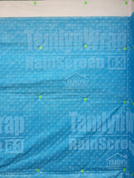

Or how about this? An all-in-one rainscreen and WRB - a tough, synthetic 19-perm WRB covered by a 6.3mm (1/4-in.)-thick rainscreen assembly. Senior architect Joe Fong AIA / NCARB / RID / LEED AP BD+C, a building envelope specialist at Tamlyn says that they have developed this new rainscreen 6.3 that will be market ready soon. To be available in 5 ft. by 50 ft. rolls, the material is uncompressible, needs no additional detailing at the top and bottom, has a 96% drainage capability and a UV-resistance maximum of 120 days. Unroll it, cap-staple it to the sheathing, and you’re done. Seams are sealed with a proprietary tape; openings should be flashed and windows installed before the rainscreen is attached. Tamlyn is also manufacturing a 10.1mm-thick product to satisfy Canadian building codes.
