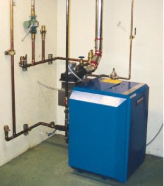

The building we retrofitted was a small passive solar house built in 1983 in upstate New York. Backup heat was provided by a small woodstove. Although the existing system worked well, the retired owners were interested in adding a fully automatic heating system for times when they were away in winter. The fact that the local utility was installing a gas main up the road made it the time to act.
The boiler uses a 3-inch-diameter stainless steel power venting system to avoid the need for a new chimney.
The house had an existing utility room for the water heater and firewood storage. Available space for the boiler was tight but adequate. We selected a power-vented boiler to eliminate the need for a new chimney. Exhaust gases exit through a 3-inchdiameter stainless steel vent pipe to an outside terminal. We chose a boiler with output somewhat larger than the required heating load, in case the owner later wanted to add domestic water heating or a future zone for garage heating.

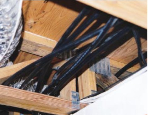

We took advantage of the fact that the home’s floor deck was framed with openweb floor trusses. It allowed us to snake the 1/2-inch tubing from the open-frame ceiling of the mechanical room to almost any other location in the floor deck. From there it was a matter of how to bring the tubing up to floor level.
In some locations we routed it through stud wall cavities. In other spots masonry walls didn’t allow us this option. Here the tubing was surface-mounted using Genova CPVC stand-off clips to hold it in place. We installed the clips approximately 24 inches apart along straight lines. Once the clip is mounted the tubing simply snaps into the open end.

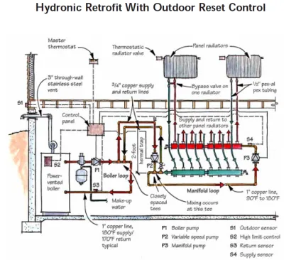

The illustration above shows a piping schematic of the overall system. The temperature of the water supplied to the radiator circuits changes based on outdoor temperature. The colder it is outside, the warmer the water supplied to the radiators.
This strategy is called outdoor reset control. It has been used with radiant floor heating systems for years, but is equally applicable to other types of hydronic heating. The idea is to make heat output from the radiators equal to heat loss from the house over a wide range of outside temperatures — sort of like a cruise control for the heating system. It has the advantage of minimizing variations in room temperature as compared with radiators that must cycle on and off because they’re always supplied with high-temperature water.
Conventional electric thermostats can also be used in lieu of thermostatic radiator valves for zone control. With this setup, each thermostat operates a lowvoltage valve actuator on the return manifold. When signaled by the thermostat, the actuator opens a valve, which allows flow through a single tubing circuit. An “end switch” in the actuator then signals for boiler and circulator operation.
Regardless of which type thermostat is used, water temperature is adjusted by mixing hot water from the boiler with return water from the radiators. The manifold loop shown in the schematic has water circulating through it whenever any radiator needs heat. The rate of hot-water injection into the loop depends upon the speed of a variablespeed circulator (P2 in the schematic) that is regulated by a micr-oprocessorbased controller. The faster this circulator runs, the warmer the manifold loop gets, and the greater the heat output of the radiators.
