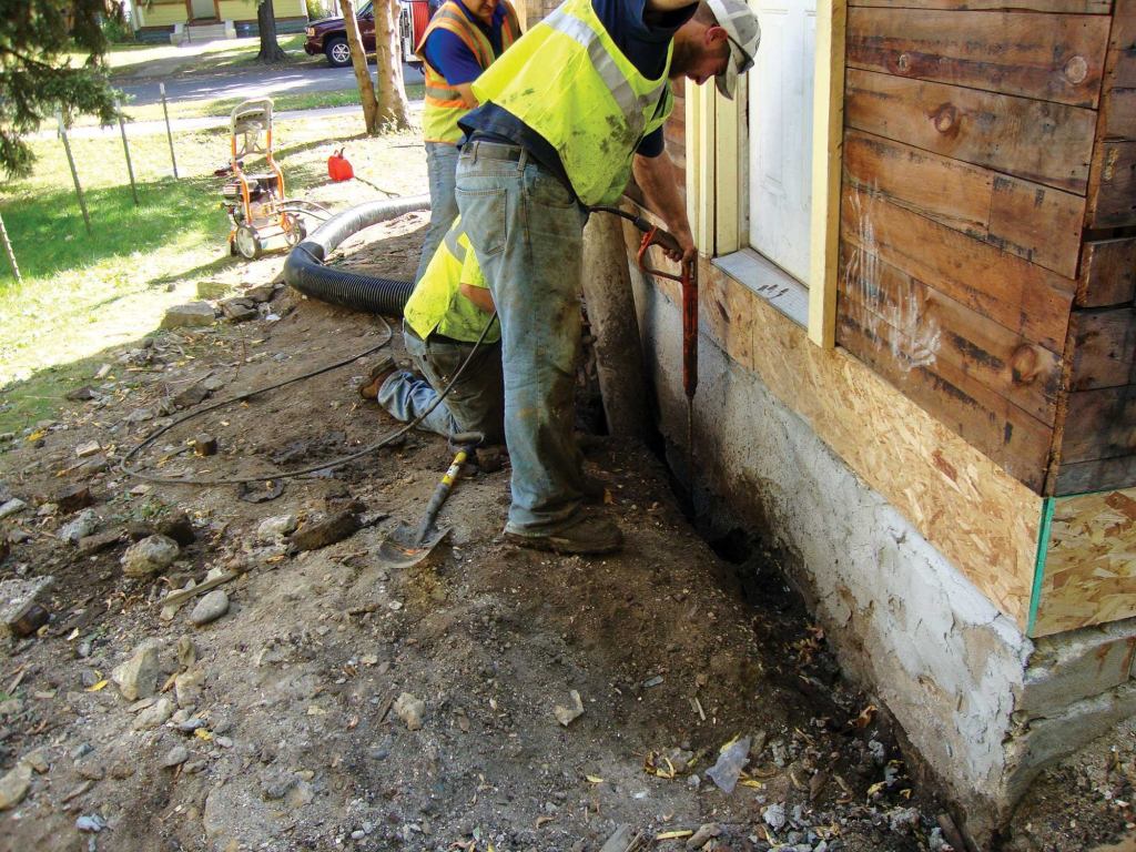

A “water knife” (a power washer) is used to slice a narrow slot around the perimeter of a house in Minneapolis. The Building America project successfully demonstrated that exterior foundation insulation can be cost-effectively retrofitted on existing homes to boost energy savings and help control moisture migration through the foundation.

“Excavationless” retrofit strategy. In an exploratory study, published early in 2013, the NorthernSTAR team examined all of the variables involved with retrofitting exterior foundation insulation and considered all the options available as retrofit strategies. The strategy that rose to the top, at least on paper, was an “excavationless” approach that involved cutting a narrow slot near the foundation and filling it with a “pourable” polyurethane foam—a low-expansion, closed-cell formulation that cures more slowly than the usual spray-applied variety. The pourable foam can be applied in a much thicker layer to fill the slot without risk of spontaneous combustion caused by an exothermic curing reaction.
To cut the slot, the technique that seemed to hold the most promise uses pressurized water to loosen soil and a truck-mounted vacuum to remove the loosened slurry through a hose. This technique, which sometimes uses compressed air rather than water, derives from an operation called “potholing” that utility companies commonly employ to sink small, deep holes when locating utility lines.
Retrofit in action. Last summer, the NorthernSTAR team got its first chance to put these ideas into practice, retrofitting exterior insulation on a turn-of-the-last-century, two-story home in Minneapolis. Using a “water knife” and a truck-mounted vacuum, the crew was able to cut a fairly consistent slot around almost half the house. In some places, sandy backfill could be removed using just the vacuum, but this resulted in a fairly wide hole. In other places, rubble from an earlier addition caused trouble, and the sides of the trench opened up. When it came time to pour the foam in these wide spots, a piece of OSB was needed to contain the pour and maintain uniform thickness. The slotting technique avoided most of the common obstructions near the foundations. At concrete steps and other unavoidable obstacles, the water knife was used to tunnel underneath, so the foundation could still be insulated. Penetrations from water, electrical, and gas lines were identified from inside, and the crew moved cautiously around these. But these delicate obstacles are what the “excavationless” technology was designed for, and the crew was able to clear these without damage to the lines.
Pat Huelman, Coordinator of the Cold Climate Housing program at the University of Minnesota and a member of the NorthernSTAR team, admits that whatever could go wrong on this first project did. But in the end, the team proved that the techniques were feasible. Compared with any other technology—a backhoe, chain trencher, pick and shovel—the water knife was incredibly efficient. The down side was that no perimeter drainage could be installed in such a narrow slot. But it’s a calculated trade-off. The home didn’t have drainage to begin with, and the water-resistive nature of the foam would reduce moisture flow and allow the home to dry to the interior.
To complete the retrofit, the team extended the pourable foam with rigid foam insulation above grade to cover the rim joist. Insulating the rim joist brings it inside the thermal envelope, which helps keep it dry. This is better than insulating the rim on the interior within the joist bay. Even when air-sealed, this isolates the rim joist to the cold exterior. If the rim sees moisture, which will inevitably wick up from the sill, it tends to rot. Huelman says that there are many ways to make the transition from the poured foam to the above-grade portion, and the method tried this first time can be improved on future projects. But overall, the project was successful in demonstrating what used to be just a pipe dream: a cost-effective retrofit strategy for insulating the exterior of basement walls.
