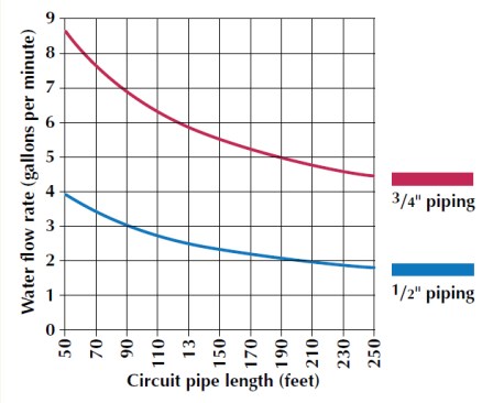

Heat output also depends on the flow rate through the element. The higher the flow rate, the higher the heat output. Graph B gives the flow rate in a series piping circuit powered by a typical 1/25 horsepower wet-rotor circulator.

Graph B. This graph gives the estimated water flow rate in piping circuits of different lengths. An allowance has been made for a typical assortment of fittings and valves.
Step 2: Estimate the flow rate through the baseboard using Graph B (above).

Step 2: From Graph B, the circuit flow rate is estimated to be 5.5 gpm.
