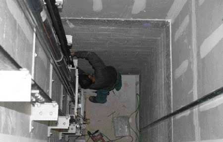

Roped hydraulic. The lifting power for a roped hydraulic elevator is provided by a hydraulic pump that's connected to a long piston with a sheave on top.
Roped hydraulic units use a piston to raise and lower a sheave. Cables pass through the sheave and connect to the sling that supports the cab. When the piston moves, the cab moves, too.
The pump is installed in a machine room, and the piston is bolted to the wall in the hoistway. A pair of cables anchored to the floor of the shaft pass up through the sheave and then down to the large L-shaped frame (cantilever sling) that supports the cab. The cab moves 2 feet for every foot that the piston moves.
