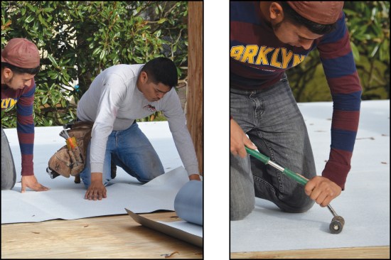

We started by installing the Deckguard HT peel-and-stick underlayment to the roof sheathing (see photos, below), so we could have a dry interior for the building. For a belt-and-suspenders approach, we applied Henry Rubberized Wet Patch roofing mastic to the seams of the underlayment. Peel-and-stick underlayment on low-slope roofs, when acting as a temporary roof before a permanent one is installed, tends to leak through capillary action. The roofing mastic helps prevent that, and it adds robustness to the underlayment in service for permanent water and air control.
The roofing crew applies peel-and-stick underlayment to the plywood roof deck (above left), rolling the material under pressure to create a good bond (above right).

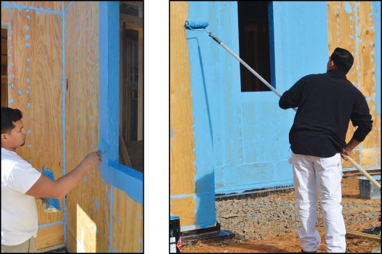

Next, we applied the Blue Barrier system to the walls. There are three components to Poly Wall’s system: Joint Filler 2200, a thick gun-applied structural adhesive and detail sealant; Flash ‘N Wrap 2400, a thick trowel-applied flashing for windows and doors; and Liquid Wrap 2300, a roller-applied or spray-applied covering that serves as a vapor-permeable membrane that protects against air leakage and bulk water. All three formulations are based on the same chemistry: STPE (silyl terminated polyether).

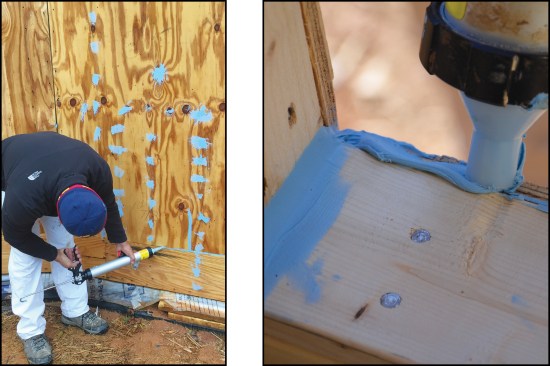

Our painting crew installed the Blue Barrier system. They started with the joint filler, installing it in every plywood seam (see photos, below). The framers had left a gap the size of a 16d nail between all the sheets of plywood, to allow for a strong, thick bead of sealant. They had also set the nail-gun compressor to slightly overdrive some of the nails, so every overdriven nail head received a dab of sealant.
At the juncture where the wall meets the foundation, we had left a half-inch gap between the wall sheathing and the foundation slab. The painters inserted backer rod into that gap, then applied and tooled a bead of joint filler.
Click to enlarge
The painters apply Joint Filler 2200 to sheathing cracks and nail holes (above left), as well as to window rough-opening corners (above right).
The painters applied Joint Filler 2200 to the corners of window openings as well, then trowel-applied Flash ‘N Wrap 2400 flashing to the rest of the opening (see photos, below). The crew installed 2400 at every door and window opening, covering the jambs, head, and sill of the opening, and then 4 inches onto the face of the plywood sheathing, at a minimum of 25-mil thickness. Thickness was verified with a mil gauge while the product was still wet.
Finally, the painters roller-applied 2300 Liquid Wrap over the entire shell of the building (see photos, below), covering all wall sheathing, and all previously installed 2200 and 2400. The minimum thickness installed was 40 mil, verified with a mil gauge.
Click to enlarge
The painters apply Blue Barrier Flash ‘N Wrap 2400 to a window rough opening (above left), then roll Liquid Wrap 2300 onto the field of the wall (above right).

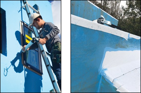

At the top of the wall, the roofing crew had left the peel-and-stick hanging a few inches past the edge of the wall. When the painters reached the top, they applied a bead of Joint Filler 2200 to the plywood joint between the roof sheathing and the wall sheathing. Then they folded the peel-and-stick down, adhering it to the wall with a bead of 2200 and staples (see photos, below). Finally, they sealed that joint with a 50-mil-thick layer of 2400, covering at least 3 inches of both peel-and-stick and sheathing and taking care to seal over every staple.
Windows were next. We used Marvin windows with a nailing fin, putting a screw in every hole in the flange. Then the painters came back to trowel apply another coat of 2400 over the flanges and extend the 2400 at least 3 inches past the flanges. Minimum thickness of this application was 25 mil. Overall, the average thickness of the Poly Wall at the windows is 50 to 60 mil, with some areas as thick as 80 mil.
Joint Filler 2200 was used to seal the window flanges (above left). At the wall top, the overhanging peel-and-stick underlayment is sealed to the wall with Joint Filler 2200 and Liquid Wrap 2300 (above right).

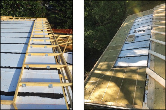

Once the Poly Wall step was complete, the insulation was delivered. We installed outriggers to the exterior of the air and vapor control layers at the roof edges to support the roof overhang, and then began to insulate the roof (see photos, below). (The framing crew installed all the insulation and strapping for the roof as well as the walls.)
Click to enlarge
Outriggers are secured to the roof deck with structural clips (above left), and the roof deck is insulated with Rockwool Toprock DD (above right).
The outriggers are framed with 2x4s on edge, fastened through the sheathing to the roof trusses using StiffClip CL structural clips made by The Steel Network, and specified by our project engineer. We insulated between the outriggers using 3 1/2-inch-thick Rockwool Toprock DD, then covered the whole field of the roof with that same thickness. Then we went back over everything with a second layer of 3 1/2-inch Toprock, for a total Rockwool thickness of 7 inches, or about R-30. We strapped over the insulation diagonally, fastening the strapping to the framing below with 9-inch screws. Every 8 feet, we cut a gap in the strapping to allow ventilation air to move in the cross-strapping direction. At the roof edge, we installed Cor-A-Vent vent strips around all four sides of the roof.

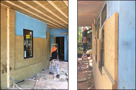

On the walls, the crew installed two 2-inch-thick layers of Rockwool Comfortboard 110, staggering the joints both horizontally and vertically (see photos, below), for a total of 4 inches thick (about R-16). The material came in 2-foot-by-4-foot panels; the crew ripped the first course down to one foot in width and tacked the pieces to the wall using screws with 3-inch metal washers. Then they stacked successive courses up. The material is stiff and rigid enough that it can be stacked as high as 10 feet without our fastening the pieces to the wall. Then the crew applied the outside courses, temporarily tacking the outer pieces to the inner pieces with the 7-inch screws they were using to fasten the strapping. Finally, they applied the strapping, screwing it to the framing inside (see photos, below).

The walls are insulated with Rockwool Comfortboard 110, with joints staggered (above left and right). Later, the insulation is secured to the wall with battens and long screws.
At the time the insulation was being installed, the interior studs were still exposed so that the crew could tell where the studs were. They took care to screw into the framing; in case they should miss a stud, they were instructed to leave the screw in place, not back it out, and use a second screw to hit the stud. That way, the membrane would seal around the screws, and we wouldn’t leave any small air-leakage holes.
Part of the house has horizontal lap siding and part has vertical plank siding. We ran the strapping either vertically or horizontally, accordingly, to provide nailing. But at the corners of the house, we ran the strapping horizontally so that we could cantilever the ends all the way out to the corners, where there was no framing behind the insulation. We made sure to span two studs with these horizontal pieces. We installed vertical blocking between the horizontal pieces at the outboard end, securing the blocking in place with wide staples.

The shell has a continuous blanket of Rockwool. Strapping holds the insulation in place and provides nailing for the siding (above left).

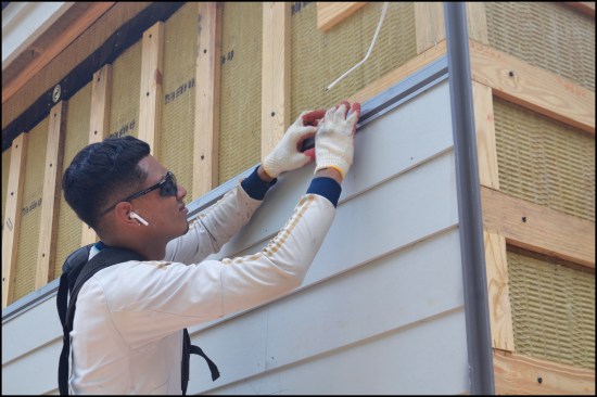

The house received standing-seam roofing with a 1 1/2-inch standing seam (see photos, above). For siding, we chose Trespa composite siding for the vertical treatment, and Nichiha fiber cement for the lap siding and panels. All the wall trim, supplied by Fry Reglet, is metal, which enabled us to terminate the siding without caulking (see photos, below). The result is a tough, durable water control layer covering a continuous, uninterrupted thermal control layer (the Rockwool insulation), which in turn protects a resilient, continuous air and vapor control layer (the Poly Wall Blue Barrier and the Polyguard peel-and-stick roofing underlayment). This house should provide the owners with many decades of maintenance-free serviceability.
The siding crew installs Fry Reglet metal trim pieces.
