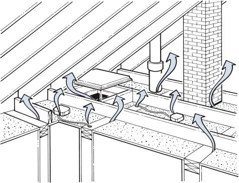

Air-Sealing Attics
The ceiling plane between the conditioned space and the attic is typically a large area, and there’s a big payoff in beefing up the insulation and sealing air leaks here simply because there’s so much real estate.
All of the penetrations for wires, ducts, and pipes must be sealed with caulk, foam, or building tape.
Common Attic Leaks
Recessed light fixtures and duct boots are often big offenders (see Air-Sealing Priorities above). If the light fixtures will be used in a cathedral ceiling, read that section below.
You can reduce leaks around light fixtures by making a box from foil-faced rigid foam insulation and sealing it in place with expanding foam. Seal around the electrical feeds and the mounting brackets with expanding foam.

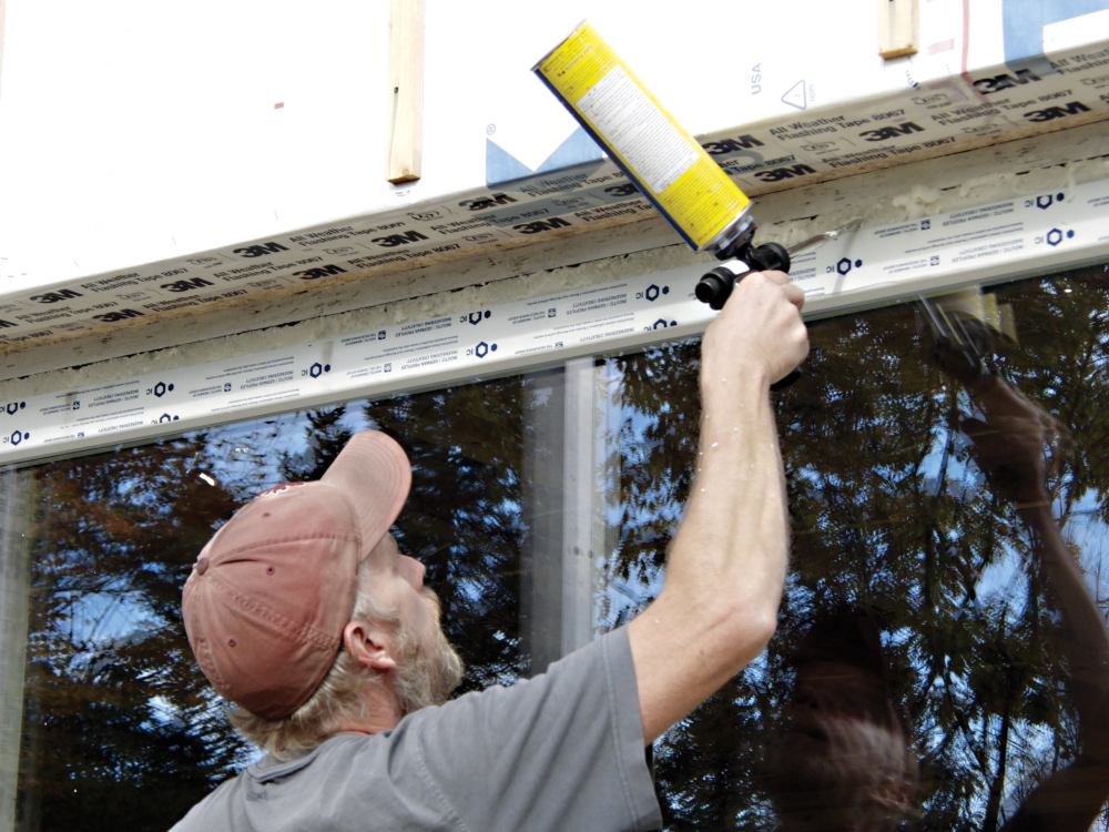

Windows are part of a building’s air barrier, and they must be connected to other components of the air barrier in order to keep air leaks to a minimum.
The Building America program recommends applying the air seal between the window unit and the rough opening toward the interior edge of the window frame. This creates the least interference with drainage. And this way, the seal is pressure equalized with the outdoors, so there’s no air pressure difference to push moisture into the joint.
The window should be sealed into the rough opening with an impermeable material—fiberglass insulation stuffed into the crack is not an effective air barrier.
Air barrier tape, caulk (used in conjunction with backer rod for large gaps), and low-expansion foam sealant all are materials that can be used.

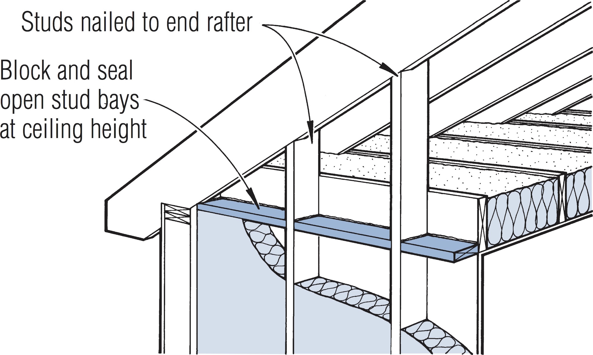

Knee-wall cavities are best insulated before the knee wall is framed. If insulated after the knee wall is framed, be sure to include ceiling blocking to stop airflow through the cavity (A). Cantilevered floor sections will create a thermal short-circuit unless blocked with 2x or rigid foam (B). Blocking in balloon-framed exterior walls will reduce convective air currents in the walls that can short-circuit the ceiling air barrier and insulation (C). Before framing eyebrow roofs and other framing projections, sheathe the exterior walls first. The sheathing will air-seal the wall cavity. Similarly, extend the ceiling above soffits or seal with plywood, as shown (D).
Knee walls. A common problem with knee walls is a lack of blocking below the knee wall’s bottom plate. This allows cold air from the attic or the outside to move through the insulation and into the ceiling and attic. Install blocking between joists, and seal the perimeter of the blocking with caulk or foam sealant.
When knee walls contain ducts and pipes that make effective insulating and air-sealing impossible, shift the thermal and air barriers to the slope of the roof. Add a layer of rigid foam insulation to the bottom of the rafters and seal all of the seams and the perimeter. Fill the cavities with blown-in cellulose or fiberglass. Or, use closed-cell spray-foam insulation to insulate and provide an air barrier.
Balloon-framed and gable walls. In a balloon-framed wall, studs run all the way from the sills to the rafters. At the attic line, there’s typically a gap between the first ceiling joist and the exterior walls on the gable ends. These must be blocked and sealed to prevent air from leaking into the attic. The blocking can be made from a variety of rigid materials, as long as the perimeter is carefully sealed.

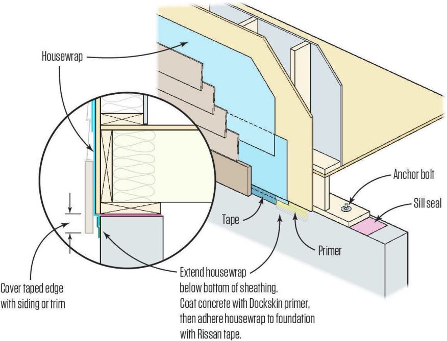

Air sealing at the sheathing layer. Huber’s Zip Wall System, in which all seams are sealed with a proprietary tape, or taped housewrap can be an effective air barrier on conventionally framed exterior walls.
When using housewrap, fasten it to the wall with cap fasteners, or use staples at seam overlaps only.
Holes in the housewrap, even small ones from staples, compromise the air barrier.
Tim Healey Holes in the housewrap, even small ones from staples, compromise the air barrier.
All seams and edges must be taped (particularly at the base of the wall), and all holes for vents, electric and water service must be sealed. (See Weather Barriers and Flashing.)
