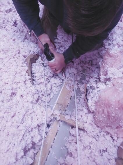

The worst example of failure I’ve encountered so far was a slab-on-grade home that, based on the home’s volume, needed to test at 800 cubic feet per minute at 50 pascals (800 CFM50), but was actually at about 3,000 CFM50. [Editor’s note: For an explanation of the relationship between CFM (cubic feet per minute) and ACH (air changes per hour), see “Blower Doors for Builders,” by Jake Bruton (Mar/19).] Fortunately, the builder had not yet installed the baseboard trim, so we were able to access the area at the base of the exterior walls and caulk that joint. The home’s ductwork was in the attic, and none of the duct registers were sealed at all, so we took care of that. Then there was a large room with a vaulted tongue-and-groove ceiling with no air barrier behind it. This unsealed ceiling was applied to a scissors truss, so, luckily, it could still be accessed from above.
We quickly realized that we weren’t going to be able to air-seal the back of the tongue-and-groove ceiling with all of the insulation in the way, so we emptied the attic of insulation. Next, we cut Tyvek housewrap the width of the trusses and rolled it down on the top side of the ceiling between the trusses. Then, using two-part foam, we sealed the Tyvek to the sides of the trusses.

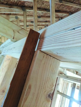

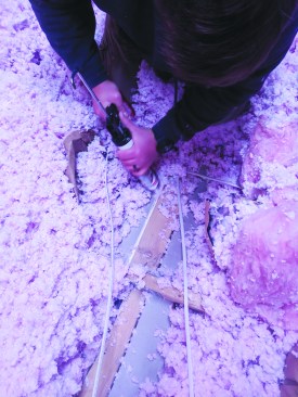

The joints between the wall drywall and the top plates—specifically, top plates that are exposed to an attic space, whether they are exterior-wall top plates or interior-partition-wall top plates—are often huge air-leakage areas. When you’re framing a wall, if the stud is proud of the top plate by even 1/8 inch, the wall drywall is pushed far enough off the top plate to create a gap along the top plate that communicates between the wall cavity and the attic. Air from the unconditioned attic moves everywhere from there: I find air infiltration at interior door strikes, at all of the outlets, at switches, and at heating and cooling registers.
Studs often stand proud of the top plate—here, by a strong 1/8 inch. This situation will hold the drywall away from the top plate, allowing a pathway for air infiltration from the attic if not addressed.

The author seals this joint from the top in a home that failed its code-mandated blower-door test.

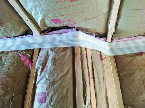

Of course, it’s better to make the air-seal during construction, instead of as a repair after failing a blower-door test. One solution that I recommend to builders is to use sill-sealer gasket material on their top plates to help cover that void. When you roll out this 7-inch or 8-inch sill-seal gasket over the top plate, it makes a nice little gasket that the drywall can seal up to. Habitat for Humanity started doing that in my area and saw a significant improvement. The first house that I ever tested for the organization was at 9 air changes per hour, and now its houses are at about 2.

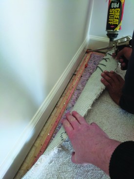

In my market, two-story entry foyers are common, and it’s typical to find stairs to the second floor in that room. I frequently find leaks at the stair landing where it connects to the balloon-framed wall. The leak occurs where the drywall contacts the landing. If it’s a carpeted landing, sealing that joint is as simple as pulling the carpeting back and caulking under the trim, and then tucking the carpet back in. If it’s a finished hardwood floor, things are a little bit trickier: Sealing the joint requires pulling the trim off to access the joint between the drywall and the floor.

Without the blocking, air pours through the gap beneath the baseboard. The author pulls back the carpet at a landing in a finished house and seals the joint with gun foam.

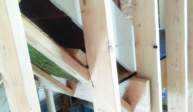

Another trouble spot I see quite often is where a staircase attaches to a wall between a house and the garage. In this case, there’s usually a false ceiling on the underside of the staircase, and a wide-open air gap between the stairs and the garage wall. If the drywall on the garage side isn’t sealed to the slab, which it’s usually not, then air can readily find its way into the garage wall, and then into the underside of the stairs, and then into all sorts of framing cavities in the main house.
A stair against a garage wall creates a highway for likely air infiltration.
To address this air-leakage pathway, I ask the builders I work with to seal the joint between the drywall and the garage slab or the band joist on the garage side of the wall. I also recommend installing an air-barrier material such as rigid foam board over the air gap between the staircase and its false ceiling. This is not a condition that can be easily addressed once the house is finished, so it should be taken care of at the framing stage.

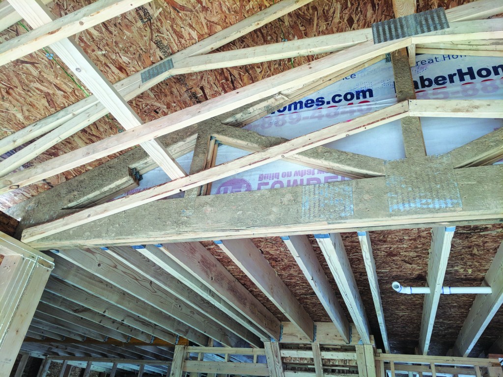

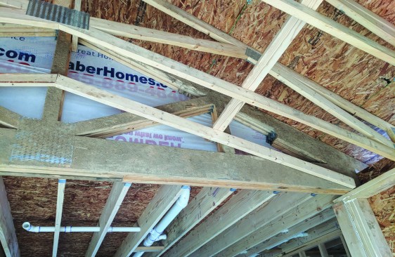

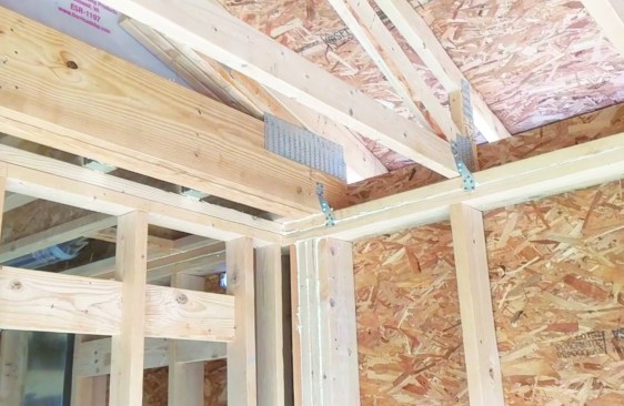

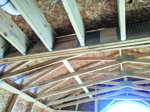

Another condition that I often see involves the juncture of a first-story scissors-truss roof (or flat attic) with a second-story wall. A potential problem exists wherever a laminated beam or girder truss is required to carry the second-floor floor joists with hangers. A typical situation is a one-story morning room abutting the back of a two-story main house. In the example shown here, a tripled-up girder truss supported the floor framing for the second floor of the main house, with the floor joists hung off of the truss. The vented attic of the lower space contacted the wall of the second story and its floor framing—which is also the ceiling framing for the first floor of the main house.
A scissors-truss roof abuts a carrying beam for a floor system ...
A scissors-truss roof abuts a carrying beam for a floor system …
... as does this flat ceiling truss.
… as does this flat ceiling truss.

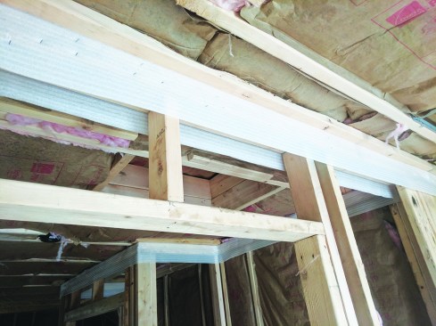

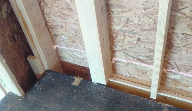

The hangers of the floor joists hold the drywall down from the girder truss, and the second-floor subfloor can’t reach all the way out to the edge of the girder truss because the chord members are in the way. As a result, a pathway is opened up for unconditioned air in the ventilated lower attic to move into the first-floor ceiling assembly and down into the room through recessed lights—or, depending on the air pressures, for conditioned air to find its way into the attic. This is just about impossible to fix once the house is finished.
The leakage pathway is visible when the framing junction is viewed from the other side
The time to address this problem is at the pre-drywall phase. At that point, critical air leak points can be identified and sealed with gun foam. The bottom of the girder truss or laminated beam should be gasketed as well. I usually recommend that the builder or framer staple sill-seal gasket material on the underside of any place there are hangers supporting the second-story floor joists. This gasketing will seal the joint between the drywall and the beam or girder truss.
