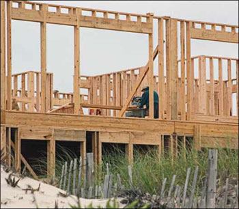

It all begins at framing: The earlier in the process builders start thinking about air-sealing, the more energy-efficient, durable, and comfortable a home will be.
As building scientists working to improve the durability, comfort, and energy performance of homes, we spent years back in the 1980s trying to make houses more airtight. The initial efforts focused on things like sealing and caulking windows and weather-stripping doors. But that was before we realized it would be much more effective to focus first on the framing.

The big concept. To build a high-performance house, the designer (or builder, if you’re doing the design work yourself) should call out on the plans the location of the air-pressure boundary for the house and the details that are required to maintain that boundary at various framing intersections.
First, the builder needs to make sure that the appropriate materials are on site during framing, and the framer has to address any potential gaps or disconnects in the conditioned envelope at the framing stage — such as installing solid blocking or solid sheet materials wherever they’re needed to complete the air-barrier assembly.
Second, in our experience, the insulation and air barrier should be in contact with each other at all times. This reduces the possibility of having air channels between the insulation and air barrier that may lead to convective losses.
Any holes for wiring, plumbing, vents, and so forth that get punched through that sandwich of air barrier, vapor barrier, and insulation materials should be carefully patched by whatever trade made the hole. We’ve found that if the three systems — vapor barrier, thermal boundary, and air barrier — aren’t installed in continuous contact with one another, and if their integrity is not preserved right through the end of the job, they don’t function nearly as well. Some areas, like plumbing chases, dropped soffits, chimney framing, and unlocked floor structures, can create places where the air barrier and the insulation are misaligned. When the thermal and air barriers are misaligned, the insulation is no longer insulation; it is a high-efficiency air filter. In addition, voids and gaps in the insulation can cause convective loss between the insulation, drywall, or sheathing that short-circuit the insulation. All of these thermal bypasses compromise the energy efficiency, durability, and comfort of the whole building.
