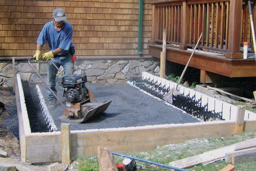

Insulation for Unheated Garage Slabs
An unheated structure, such as a detached garage, needs continuous insulation under the entire slab, extending out beyond the perimeter (below). Since there is no building heat to capture, this insulation is intended to prevent earth heat from escaping.
Foam for Frost-Protected Shallow Foundations
In this design, the footing and slab are bearing on the foam. By code, the foam used for frost-protected slabs must have a density of 2 lbs. per cu. ft. Most expanded foam stocked by lumberyards is only 3/4-lb. or 1-lb. density and lacks sufficient compressive strength. High-compression foam usually needs to be special-ordered.
