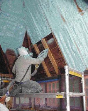

I work for a company in Northern California that installs spray polyurethane foam (SPF) insulation, and we are frequently asked to insulate unvented assemblies. Sometimes the building has a flat roof or a cathedral ceiling that would be difficult or impossible to ventilate. In other cases, the existing framing cavities are too shallow to accommodate a sufficient amount of insulation plus a vent space. And occasionally customers request unvented attics because they make the building more comfortable and energy-efficient.
Spray foam is a good choice for roofs that are difficult to vent, like a turret with converging rafters.
