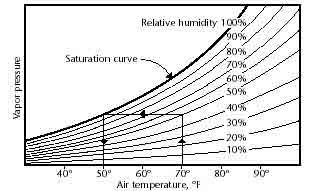

The good news is that because of the thermal resistance of the interior foam, the wall cavity will rarely be below the dewpoint temperature of the exterior air (see “Psychrometric Chart,” below). The bad news is that if moisture ever gets into the wall — say, due to a window leak or negative pressure caused by leaky attic ductwork — it won’t be able to get out easily.

A psychrometric chart provides the dewpoint for any given air temperature and relative humidity. Say you have a relative humidity of 50% at 70°F. On the horizontal scale, locate the air temperature and move up to the curve that represents 50% relative humidity. Then move left to the saturation curve and down to find the dewpoint — 50°F in this case.
