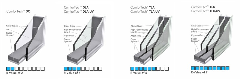

Let’s start with the simplest glazing unit and work our way upwards with available options.
  • Double Glazed with Clear Glass and non-metal spacer - R-value of 2
  • Double Glazed with Low-E Glass on one pane, Argon Gas and non-metal spacer - R-value of 4
  • Triple Glazed with Low-E Glass on two panes, Argon Gas and non-metal spacer - R-value of 6
  • Triple Glazed with Low-E Glass on two panes, Krypton Gas and non-metal spacer - R-value of 9
ProVia takes some of the confusion out of energy-efficient options with their simplified descriptions and illustrations.
Glazing Options for ProVia Windows
