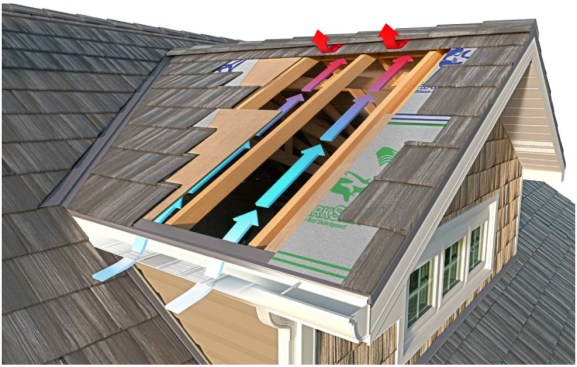

Here’s how roof ventilation works. Air enters the roof through soffit vents. As it warms up, it rises to the top of the attic, where vents at the ridge of the roof (where the two sides met at the top) provide the warmer air with a natural exhaust point.
Proper ventilation is an integral part of a roofing system and part of why it’s required by many building codes. It’s comprised of six main elements, each of which provides important benefits:
Ice Barrier Membrane. This self-adhesive layer protects the roof substrate from ice dams.
Underlayment. A water-resistant barrier, it provides additional protection from condensation and severe weather.
Roof Panel. These steel panels deliver a design touch along with exceptional resistance to weather hazards.
Soffit Vents. This is where air enters at the eaves. These intake vents placed at the lower roof edges are critical to providing cross ventilation.
Ridge Vent. This is where hot air escapes, preventing snow melt and ice dams in the winter and decreasing cooling costs in the summer.
Ridge Cap. Installed over the ridge vent itself, this provides an aesthetically pleasing finishing touch.
