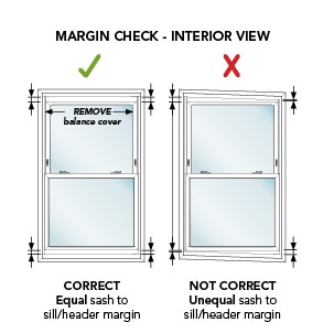

3. Ensure the window is square and plumb. Whether it’s a nail fin or not, shims are vital to proper alignment within the pocket.
Consistent margins are crucial. When setting the window unit in the opening, check the spacing between the top and bottom sash and the frame, as well as the side margins. Visually confirm that the margins are even vertically and horizontally, then use shims and jamb screws as needed to keep the unit square and plumb. (see illustration for reference)
“You’re letting the window tell you what needs to happen to make it function properly and to set those vertical margins true,” Stutzman says.

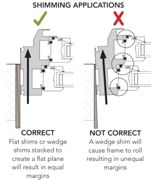

4. Avoid over- and under-shimming. The goal is creating consistent support without distorting the frame. “You want that weather stripping to be compressed but not over compressed,” Stutzman says.
Over-shimming causes excessive resistance in sash operation, while under-shimming leads to partial frame support, air infiltration, and eventual frame roll.
One of the biggest mistakes installers make is using wedge shims rather than back-to-back or opposing shims. Sliding two shims against each other with opposite tapers creates a flat, consistent surface that fills gaps and properly secures the window frame.
“That wedge shim worked in warm weather, but now that it’s cold, the window wants to contract and that wedge shim isn’t enough,” Stutzman says.
