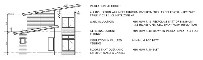

A couple of years back, we built a large home with long, open spans, vaulted ceilings, and an I-joist roof structure that could accommodate only minimum code R-values of fiberglass insulation and no viable ventilation strategy (see excerpt from the plan set at the top of this page). The aesthetic desired by the architect and owner did not allow for a thicker roof edge or fascia to accommodate a greater depth of insulation, nor did they want to introduce a greater pitch to allow for stack-driven venting. Since the jurisdiction where the home was to be built was enforcing the 2012 IRC, the architect designed it to meet the code minimum R-38 for ceilings with a reduction to R-30 allowed for “Ceilings Without Attic Spaces.” In the building code, this reduction is “limited to 500 sq. ft. of ceiling area.” I’ve met a number of code officials in our area who read this as a reduction for each individual ceiling (room to room) rather than a reduction for the whole house, and that interpretation has resulted in an awful lot of woefully underperforming assemblies.
A couple of years ago, the author was asked to build this Midcentury Modern home. The roof framing did not allow adequate insulation for the climate, forcing him to spend an inordinate amount of time on air-sealing to avoid condensation problems.
Having the minimum R-value and currently enforced code of the jurisdiction printed on the plan set has the unintended consequence of suggesting to all prospective bidders that building the home as designed would include R-30 fiberglass batts in an unvented roof. Of course, this creates an incorrect baseline of cost to the client in the competitive bidding process where all bidders include the underperforming assembly in their estimate and then try to sell what should be the minimum as an upgrade after the fact.
To make a long story short, on this particular house, the client was not in favor of expanding the budget to arrive at our desired level of performance, nor were we involved in the process early enough to win over the architect and help “design out” this potentially problematic assembly. In this situation, we had to build the plan as designed, approved, and budgeted. We then worked around those fixed points with ambitious air-sealing in hopes of avoiding future problems. So far, so good, but we lost an obscene number of labor hours trying to make the airtight drywall lid work sufficiently to protect us from the condensation risk we fear. Meanwhile, the occupant will pay higher energy bills due to this underinsulated roof for as long as the home exists in this condition.

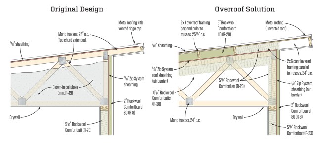

When we were asked by another client to bid a smaller home in a similar design style a year later, we went to the architect straight away with our concerns about condensation. With their design team and our firm at the table, we went through the working drawings and raised those concerns, asked pointed questions, and eventually worked together to achieve a solution that didn’t involve an unvented low-slope roof with fibrous insulation.
In lieu of a single roof assembly that achieved the vault and narrow roof edges that were desired, we suggested building two roof assemblies. One would use trusses, as originally intended, but without the generous overhangs as part of them. (On the original design, this was an extension of the top chord; see illustration below.) On top of this truss assembly, we would then build an overroof structure that would cantilever beyond the exterior walls to achieve the narrow fascia profile.
Click to enlarge.
On a recent project, the author encountered another Midcentury Modern design (above left). He was successful in persuading the architect and client to adjust the design with a robust air barrier and an insulated overroof (above right).
Illustration by Tim Healey
Truss roof assembly. Having a lower truss assembly without overhangs would allow us to more conveniently (two less turns and much less material) use Zip System sheathing at the wall and over the “under” roof to accomplish our air barrier.
Overroof. Once the Zip System was complete, we would build an independent roof volume framed in 2x6s that could project beyond the building line. This created the narrow fascia profile desired and could be insulated with a vapor-open fibrous insulation.

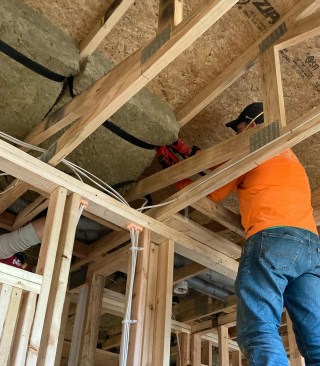

Thermal control. We frequently self-perform insulation and air-sealing, rather than subbing it out, and for many years, we’ve used stone wool in our builds since it handles and cuts in a way more familiar to us as carpenters. Being able to instantly assess the quality of the insulation install without connection details being hidden behind a piece of Kraft paper is important. And we actually enjoy working with stone wool: It is gratifying to be able to fit it precisely, and it’s reassuring to get both high performance and low risk.
Vapor control. Since Rockwool is our preferred material, we reached out to the company’s building-science team to model the performance of the assembly we proposed with the 2×6 frame and 5-inch Comfortboard. Because Zip System is not impermeable, they identified a risk that vapor from the interior of the home could move into the overroof assembly and condense on the top layer of OSB. This is a risk our friend Ben Bogie had been warning us of, as well. To remove that risk, Rockwool suggested a peel-and-stick membrane over the underroof deck prior to framing the overroof.

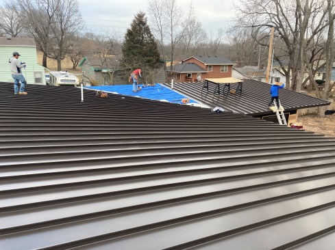

Compared to these options, the low-profile overroof solution stood out as the clear winner. As a value-add, the stone wool offered excellent noise reduction at the metal roof during rain and hail, a feature the clients were quite happy to hear about (or not hear, as it were). We were fortunate that these clients were already on board with prioritizing performance in their selections, including a smaller footprint overall, a Zehnder ERV, Alpen windows, a standing-seam metal roof, and exterior rainscreen. Our proposed revision fell in line with these planned house features. The architect provided a rendering of the assembly for approval, and we all agreed on this as the way forward. The Rockwool building-science team then verified the performance through WUFI modeling, and we reached an agreement on price with the client, so all we had left to do was build it.

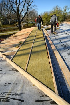

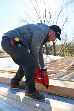

To keep costs low, we began by considering the actual labor steps for the assembly and prioritized the reduction of cuts and complexity. It would be slow to cut down rigid Comfortboard. This dense insulation board is sold in 2-, 4-, and 8-foot dimensions (actual), so in a conventionally framed assembly, it would have to be cut lengthwise to fit into 16- or 24-inch-on-center bays. To avoid this, we sought and won approval from our structural engineer to expand the spacing of our 2×6 overroof framing to 25 1/2 inches on-center. This would allow us to use full-width 2-foot Comfortboards, avoiding all insulation cuts except for one angled cut at the valley. This 45-degree cut could be used on each side of the valley, so we had only one cut for every 2 feet of travel up the roof. By starting at the valley, we would begin with that cut, place the Comfortboard in whole units, and then place a 2×6 firmly against this rigid insulation and toenail it into the truss below.

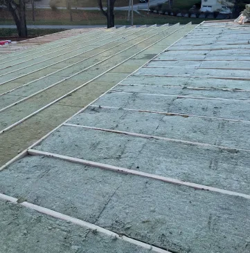

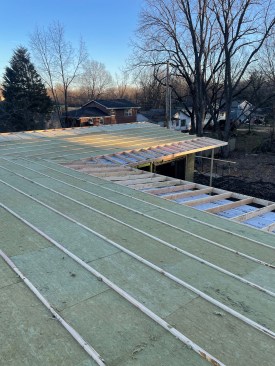

We ran the 2×6 overroof members perpendicular to the truss orientation. This limited our thermal bridging to a 1 1/2-inch square at each connection, rather than having a continuous thermal bridge along the entire length of each member. We could have eliminated the thermal bridge entirely by laying down a continuous layer of insulation boards over the roof and then running 1- or 2-by strapping as a nailer for the sheathing on top. This would have required securing the strapping with long screws into the truss chords below, which was less than ideal. We intended for this entire scope of work to be completed by our framing crew, and they want to fire nails from pneumatic guns, not drive long screws through multiple materials. But the main concern I had was that the long screws might not remain plumb through the depth of insulation and that they could miss the trusses entirely, or worse, catch the edge of a top chord and split the truss, which would require an engineered repair at every location this occurred.
To move fast, we needed to not cut, not screw, and not strap. Toenailing was allowed in the field to secure the 2×6 overroof frame to the trusses but the engineer did require a hurricane tie at each of the cantilevered overroof members where it extended out past the underroof. With the “two in, one out” ratio applied to the structural cantilever, we had our framers build ladder frames just like they would build walls—flat on the low-slope deck (see “Slideshow: Overroof for a Mid-Century Modern Home,” above). They were then able to slide these frames out to overhang the lower roof assembly the appropriate distance, creating the narrow roof edge. This meant no ladder work to add to the cost of this detail.

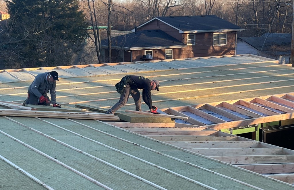

To build out the overroof, we simply installed one line of 2x6s by standing on it to keep the board flat against the deck and toenailed it to the truss below. We then laid down a piece of insulation, made the valley cut, and finished the line of insulation, pushing each insulation board snug against the 2×6. Then, we installed the next line of 2x6s, pushing them snug against the insulation. After that first 45-degree cut at the valley, there was no measuring or cutting the insulation or framing members until reaching the opposite roof edge where we would cut the 2×6 to the correct length. We would let the insulation “run wild” past the edge of the exterior wall below to complete the thermal boundary.
While the engineer had been agreeable to the toenailing and 25 1/2-inch-on-center framing in the field, he required that we stay 24 inches on-center for the ladder-framed cantilever sections in order to provide better shear nailing on the sheathing.
The sheathing in the field over the 25 1/2-inch-on-center framing did not always align on the framing. In those places, we “spliced” panels together by laying down a scrap of 1/2-inch OSB on top of the insulation and nailing any sheathing edges that didn’t fall on framing into this scrap. (The Comfortboard is 5 inches thick, allowing just enough space for the scrap in the 2×6 cavity.) While this was sufficient in the field, this was not an approach the engineer approved at the edges of the roof, where uplift and other forces are greater.
The 24-inch cavities at the edges were insulated with R-23 stone wool batts, which are made to fit the 24-inch-on-center cavity. These offered slightly more R-value than the 5-inch, R-20 Comfortboard. This meant walking joists at the edges, which was slightly slower than what we enjoyed in the field. The Comfortboard we used has a compressive strength of 110 psi, so we could walk on it with virtually no give. Sheathing the roof with commodity OSB saved us a little money, and because we covered it with a peel-and-stick synthetic underlayment and metal roofing, we weren’t sacrificing any durability. Even with the time we took to shoot video and photos, we completed the framed, insulated, and sheathed overroof in two days. The client and architect are thrilled, and my team can rest easy knowing we don’t have any condensation risks.
