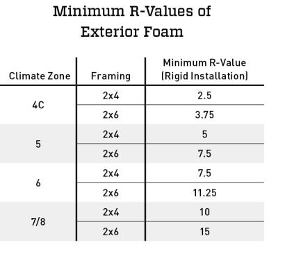

How much foam is the right amount? The guide provides the answer in clear terms via the 2009 and 2012 IRC (see table, above). If you’re building in climate zone 5, for example, you need at least 1 ½ inches when using extruded polystyrene (at R-5 per inch), and in climate zone 8, you need 3 inches (or 2 inches of polyiso at R-8 per inch). Remember, these are only minimum values to keep the inside face of the exterior sheathing above the dew point. More foam, of course, will increase thermal performance.
The prescribed values assume that the 2×4 or 2×6 wall will be filled with cavity insulation. The guidelines are careful to note that if your walls will be fatter than 2×6 (that is, have more cavity-wall insulation and a greater risk that the sheathing will reach the dew point), additional analysis is recommended. The type of analysis the authors are referring to here is the sort done by BSC on the net-zero homes built by R. Carter Scott and company, as described in this column in March (see “Moisture in Fat Walls—A Closer Look,” Mar/15).

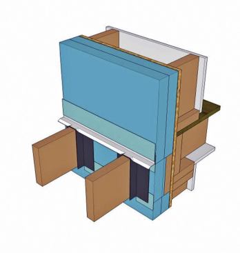

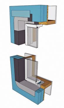

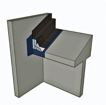

The meat of this document comes in the step-by-step guidelines for integrating the water-control layer with thick layers of foam. Many are based on real-world experience, including some documented in JLC by David Joyce, working on projects for BSC’s Betsy Petitt (see “Retrofitting Exterior Insulation,” Nov/09). But there are a number of important details we have not seen—details that are common on homes. Key examples include integrating fat foam with the step-flashing and kick-out needed for an intersecting roof (see Fat Foam Meets Side-Wall Flashing, above) and attaching a deck ledger (see illustration, left). Detailing for two cases—installing the water-control layer over the foam and under the foam—are provided.
