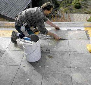

Crack-Isolation Membrane
An important aspect of this project was choosing a method to apply the stone that would reduce the likelihood of cracking caused by deflection or movement of the deck or slab. The proper way to do this is to install the stone (or tile) over a crack-isolation membrane. Also referred to as antifracture or uncoupling membranes, these materials are designed to reduce the amount of stress that can be transferred from the substrate to the finish. (For a list of available crack-isolation membranes, visit the Tile Council of North America Web site at www.tileusa.com)
