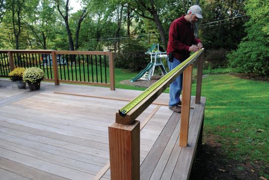

Before we cut any material, I worked with my friend to finalize the design. The plan was to fit the cabinets between the posts on the existing deck. To help us visualize the kitchen's footprint, I laid out some rippings of wood on the deck. Next we made a story pole to lay out the locations of the cabinet sides and the appliances.

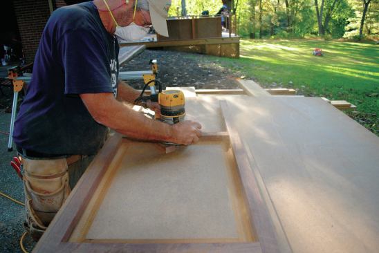

Cutting a raised-panel design in the cabinet sides was a bit more involved. I used a Whiteside panel bit (whitesiderouterbits.com) fitted with a bearing above the cutter and a template frame to guide the cut. Because of the depth of cut for the panel, I had to use 1 ¼-inch-thick material for the frame. With thinner material, the bit would have hit the Extira before the bearing made contact with my template.
Later in the construction process, when I routed the door and drawer fronts with the raised-panel profile, it was easy to unscrew the template frame to adjust its size. For all the pieces, I kept the rout about 2 ½ inches in from the edge. I attached a block of wood the same thickness as the template to one edge of the router base to help keep the router base riding flat on my template—sort of like training wheels for the router.
It took several passes around the template to get a final, clean panel cut. Cutting Extira creates a lot of dust, so I used a vacuum cleaner between passes. Even in windy outdoor conditions, it's a good idea to wear to wear a dust mask.

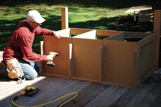

With all the sides cut and milled, I started at the trash-can end of the cabinet run and cut the first cabinet bottom and set of stretcher rails, then drilled for pocket screws. Because none of the pocket screws would be visible in the finished cabinetry, I adjusted my Foreman to drill to a depth that would let me drive 1 ¼-inch screws into the side panel without coming out the face.

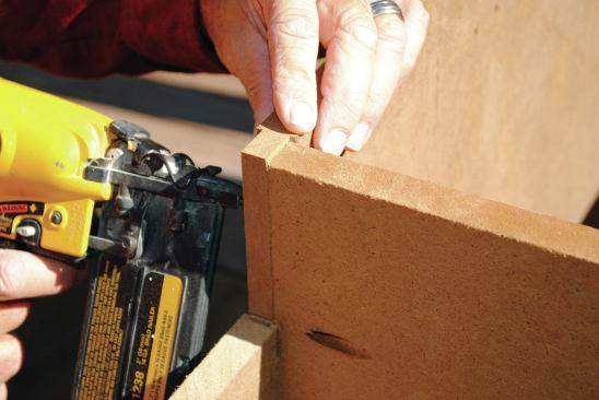

Working from one end to the other, I assembled the cabinet run section by section, first fitting each bottom piece, then adding the back, then the stretcher rails. For cabinet sides with double dadoes, I through-nailed the bottoms in place, then secured them with extra screws. The first part of the assembly was done with the cabinets on their backs, then I stood them up to screw in the back pieces.

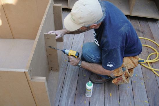

The manufacturer specified that the grill cabinet hold at least 300 pounds, so I added a vertical divider in the center of the cabinet in the toe space and glued and screwed extra cleats to the cabinet side pieces.

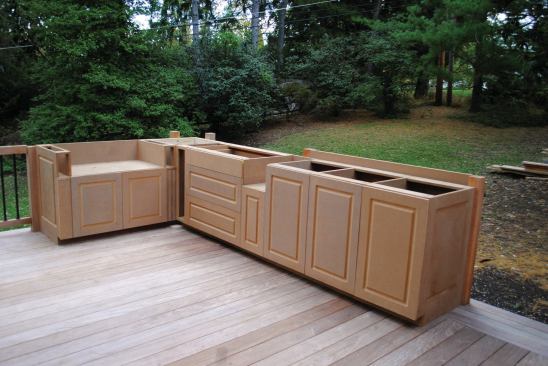

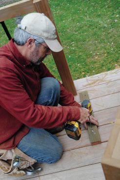

When both runs of the kitchen were built, I matched them up in the corner and shimmed them to level. I screwed cleats to the deck boards, then screwed the cabinets to the cleats. The cabinets were also screwed to the deck posts.

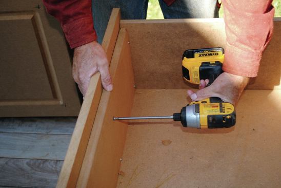

I used a 5/16-inch-radius router bit to ease both edges of the drawer-side top pieces and one edge of the front and back pieces. For extra strength I used nails and pocket screws to assemble the drawer boxes. The pocket screws through the back pieces will never be seen unless someone removes the drawers, and the pocket screws through the front pieces would be covered by the finish drawer fronts.

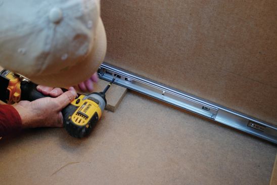

To install the drawer boxes, I first attached the slides to the cabinet side, spacing them off the bottom with a 1/2-inch-thick temporary shim. (At first I forgot the front had to be raised up an extra ¼ inch since the cabinet bottom slopes up from front to back.)
The part of the drawer slide that attaches to the cabinet side has elongated horizontal screw slots for in and out adjustments. After driving in two screws, I pulled the slides out and screwed them to the box using the vertically elongated screw slots, which allow for up and down adjustments. I didn't install all the screws yet; I would do that after the finish drawer fronts were installed.
You could use blocks and shims to hold the boxes in place while attaching the slides to the drawer boxes, but I think it's easier to have a helper hold things. Once the slides were screwed in place, I made sure the drawer boxes slid in and out freely. I've learned that it's a waste of time to make any permanent adjustments until the fronts are attached.

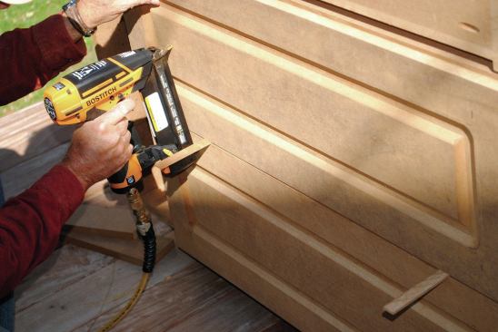

After fitting the fronts, I routed them with the same panel profile used on the cabinet ends. I set the drawer fronts in place and shot a couple of 18-gauge brads through the fronts to hold them in place until I could use pocket screws to attach them permanently from the back side.
For the bank of stacked drawers, I worked from the bottom to the top, using temporary shims between the fronts to gauge the reveals.

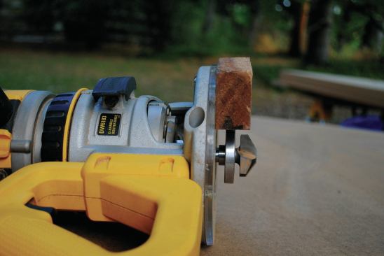

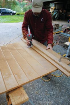

I wanted to dress up the back side of the cabinets, too. My solution was to rout vertical V-grooves into ¾-inch-thick Extira panels, using a straightedge and a trim router. To support the paneling at the outside corners, I added blocking. The crew that framed the deck did a great job keeping the posts plumb, so it didn't take much work to fit each panel between them.
I wanted the V-grooves to be spaced about 4 ½ inches apart and have the look of a full piece at each end, so layout was critical. The friend I worked with showed me a wonderful DeWalt construction app (dewalt.cengage.com/mobilepro). In a few minutes, using the app, he had a layout that worked exactly without any adjustments to the V-grooves as we got closer to the edge.
We finished up the panels just as it was getting dark on the second day of hard work. Before I headed home, everything was ready for the painters, who would do some sanding to ease some of the sharp edges, then paint the interior and exterior of all the cabinets. The stone contractor would come next to finish the countertops.
