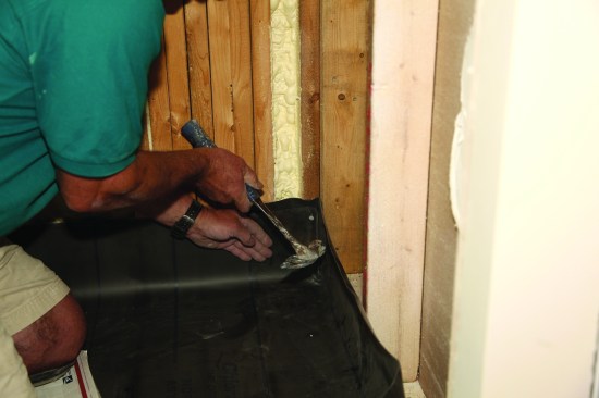

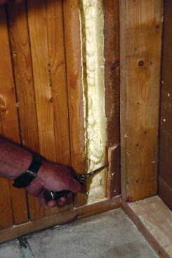

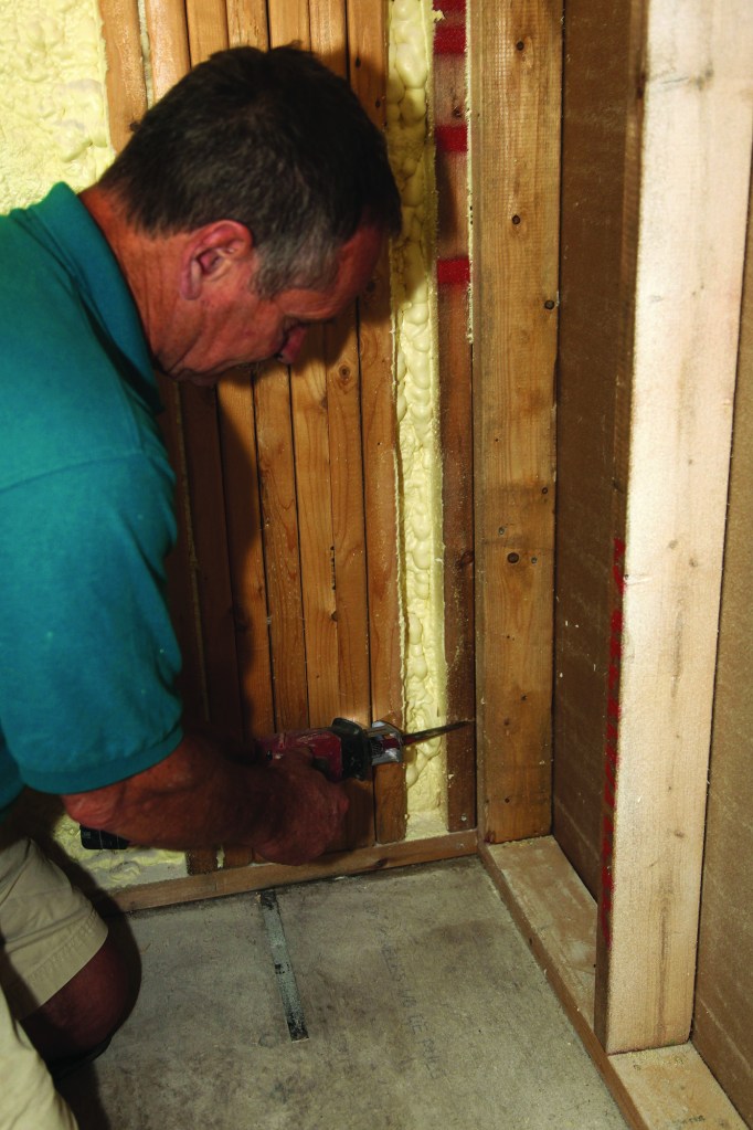

To make room for this extra material, I create a notch in the bottom of the framing at each corner. Before the first step of installing the shower pan, I make a relief cut in the stud on one side of the corner about 6 or 7 inches up. (Being right-handed, I naturally fold the membrane to the left, so I make the cut on the left stud of the corner). Using a reciprocating saw, I make the cut about 1/4 to 3/8 inch deep.
Break out the wood below the cut with a chisel or screwdriver.
With a chisel or a flat-bladed screwdriver, I break out the chunk of wood below the cut. I don’t try to be super neat at this point, and it’s not imperative that the surface of the notch be really smooth. I just make sure that nothing is sticking out of the notch surface (especially an errant framing nail) that could puncture the membrane. After cutting all the notches, I clean up all the sawdust and debris on the subfloor of the shower with a vacuum and proceed with adding the slope to the shower floor.
