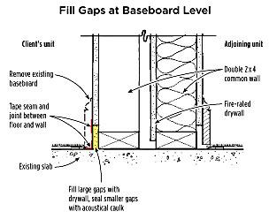

Start by getting down on your hands and knees and listening. You may discover that most of the sound is filtering in at baseboard level. Drywall hangers often leave a gap between the bottom sheet of drywall and the floor, which allows air and noise infiltration. After removing the baseboards, fill any large gaps with drywall and tape the seams, allowing the tape to mask the joint between the floor and the wall (see illustrations). Smaller gaps should be sealed with an acoustical caulk.
