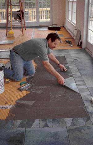

Figure 1. An uninterrupted expanse of floor tile is prone to stress cracking. Plastic expansion strips installed every 20 to 24 feet divide the field into smaller zones, minimizing cumulative movement and stress. Thermal movement at door thresholds cracks grout. It's a good idea to install an expansion strip there, too. A minimum 1 1/8-inch-thick plywood substrate and underlayment are required to limit deflection between framing members. Underlayment provides added stiffness and a disconnect between subfloor and framing movement. Proper panel layout, edge gapping, and nailing help ensure that the underlayment performs as intended.
