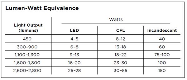

When buying an incandescent bulb, we look for wattage — which refers to energy consumption — and pay no attention to lumens, the measure of how much light the bulb produces. With LEDs, however, which use very little energy, lumens are the common unit of measure. To use this chart, match the wattage of the incandescent you want to replace to the LED that corresponds to the lumens the incandescent produces.

For now, while the public gets used to them, LEDs are mostly defined in terms of their “equivalence” to incandescent bulbs — even though they perform very differently (see “Lumen-Watt Equivalence,” top left). For example, while everyone knows what to expect from a 40-watt or 100-watt incandescent bulb, very few people know that the amount of light these lamps produce ranges from about 400 lumens to about 1,600 lumens. We are accustomed to thinking of the brightness of a bulb in terms of the wattage it draws. But the power consumption of LEDs is so low it is almost irrelevant, which makes it all the more important to understand light output in terms of lumens.

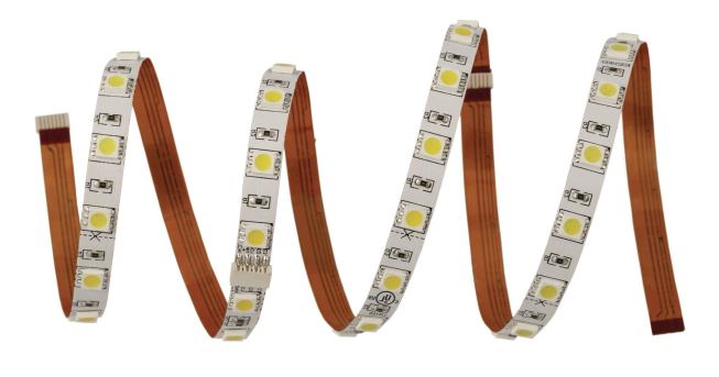

New applications. The small size and extremely low voltage requirements of LEDs have designers thinking about putting these lamps in places where lights have never been. LED tape, for example, is now less expensive and more reliable than the incumbent technology, and is an excellent choice for accent lighting or to outline stairs, doorways, or toe-kicks (see photo on page 54, bottom left).
