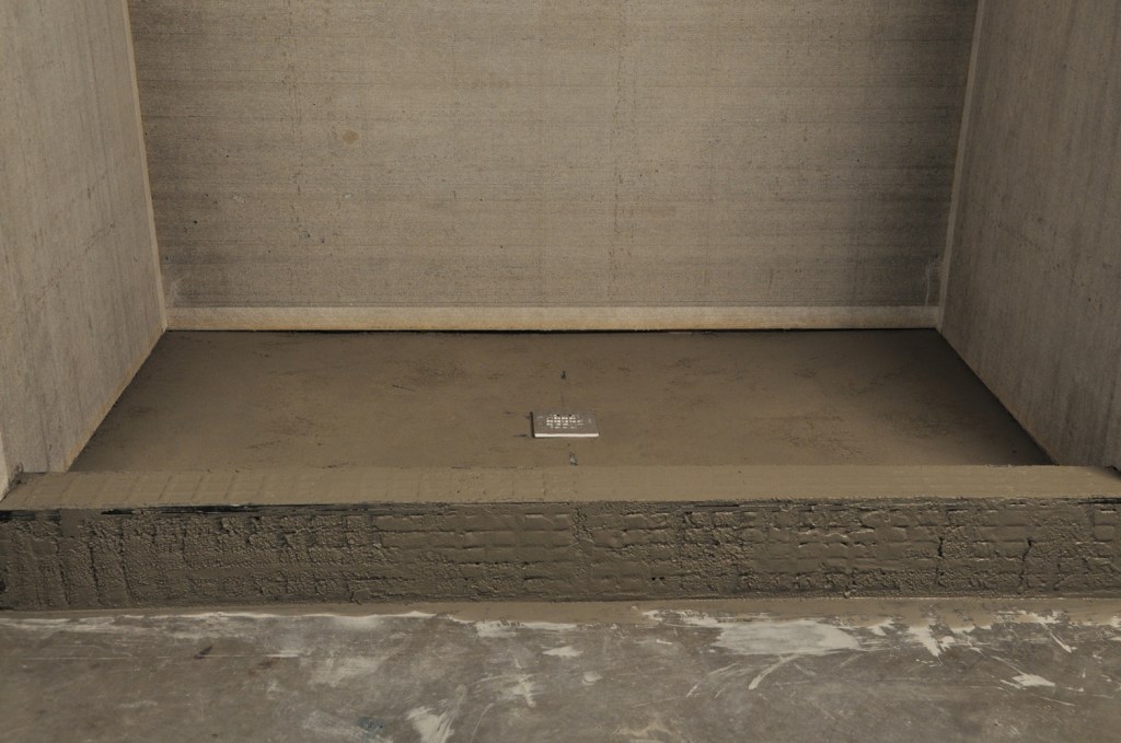

Pre-Pitch is a unique, stay-in-place screeding guide designed for use under shower pan liners. The tool creates the proper sub floor slope needed to move water toward the drain’s weep holes, guarding against “ponding” on the liner.
Kirb-Perfect is a permanent plastic form designed to guard against nail punctures in the liner on the top or inside wall of shower curbs. The product attaches to the outside wall only to eliminate water intrusion to the stacked 2x4s that create the curb.
Quick-Pitch is also a screeding guide system designed to create the proper tile floor slope necessary for good drainage, no matter where the drain is located. Quick-Pitch eliminates the need for a level saving time on the job. The Quick Pitch Float Stick System includes a Center Ring for use with 2” and 3” drains. Their Universal Center Ring accommodates thick square drain risers and most other specialty drains. In addition, both Pre-Pitch and Quick-Pitch can extend up to 6’ out from the drain.
Handi-Kirb easily creates a roll-in, wheelchair accessible shower when recessing the compartment floor is not achievable or practical. Handi-Kirb is adjustable to 3/4” in height (not including tile) for ADA compliancy.
