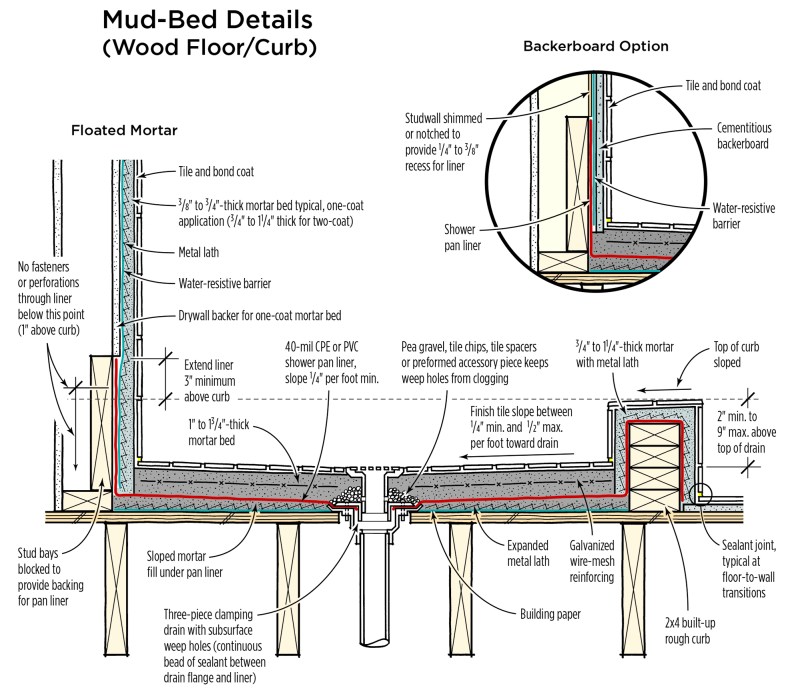

A heavy-duty membrane liner is critical to long-lasting performance.
In a typical tiled shower, the pan liner extends above the curb height on walls and is sealed in place by the two-part subdrain assembly. Any moisture that penetrates the tile floor and accumulates will exit through weep holes.
Tim Healey
For a tile shower built on a mortar-bed floor, use a heavy 40-mil plastic pan liner. Wrap it over the curb and seal it in place at the drain with a two-part subdrain assembly, as shown below.
