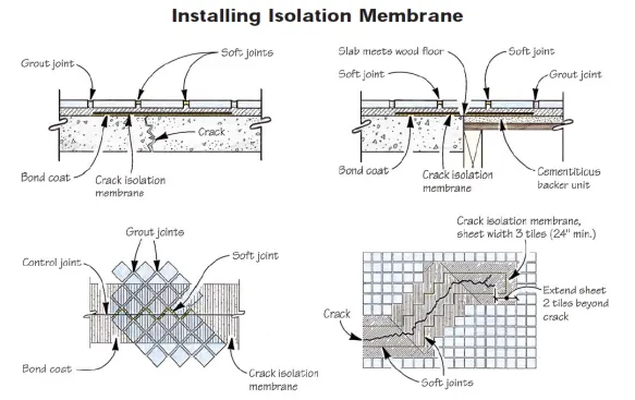

Probably 90% of the tile installation problems I’ve encountered are a result of the tilesetter failing to allow for substrate movement. Typical problem spots are vertical wall planes that intersect with horizontal surfaces, concrete substrates with control joints or random cracks, and the junctures of dissimilar materials. In these situations, a "movement joint" (my term for a broad class of expansion or control joints) should be used. Inside corners should be left free of grout, then caulked after the grout has cured. Use a high-quality silicone caulk, and install a foam backer rod in the open joint before caulking. It’s also important that all "hard" material be cleaned out of an open joint before caulking. Small bits of hardened adhesive or grout can apply point pressures to adjacent wall surfaces, causing cracks as the substrate expands.
When installing tile over a concrete slab, creating movement joints can be a little trickier. One approach is to position an open tile joint directly above any slab joints, install backer rod, and caulk. The trouble with this approach is that the location of this open joint may disrupt a patterned tile layout, or you may be forced to follow a slab joint that is crooked or out of square.
Install an isolation membrane over slab cracks and control joints (top left) and at the juncture of dissimilar materials (top right). Use a movement joint on each side of the crack. In the case of diagonal tiles (bottom left), use a zigzag movement joint. For random cracks (bottom right), movement joints should be located on both sides, following the direction of the crack.
A more adaptable approach is to use a crack isolation membrane like the one manufactured by the Noble Company (614 Monroe St., Grand Haven, MI 49417-0350; 800/878-5788). Although its use will not completely eliminate cracks, the 1/32-inch membrane material isolates the tile from the substrate movement and allows tile movement joints to be located near the slab joint instead of directly over it. The width of the membrane should be three times the tile size, and it should be bonded to the slab using either Noble’s proprietary latex-based adhesive or an acrylic or polymeric modified thinset mortar.
After the membrane is installed, the tile is bedded in thinset adhesive and two movement joints are located on either side of the slab joint (Figure 2). When the slab joint is covered by angled pattern tile, the movement joint is zig-zagged over the slab joint.
This isolation membrane is also ideal for bridging random slab cracks (a difficult item to work into a tile pattern) and joints created when two dissimilar substrates meet. The same ratio of membrane width to tile size applies, and movement joints must be located on either side of the random slab crack.

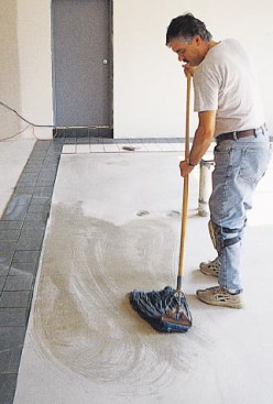

Dirty substrates create poor bonding conditions. Concrete substrates should be wet mopped and plywood substrates damp mopped, with the mop water changed regularly.

Whether you’re using an organic mastic adhesive or a Portland-cement-based thinset adhesive, there is an important sentence found in the instructions that most builders ignore. It usually reads something like this: "The approved substrate should be free from dust, dirt, oil, and grease." Bedding tile in a dirty substrate will result in a weakened bond (and in extreme cases, a nonexistent bond), and it sets the stage for cracking when the inadequate bond fails to hold the tiles in place.
Before you reach for the adhesive, all floors should be scraped and thoroughly vacuumed, using a heavy-duty shop vac. Concrete floors should be wet mopped (Figure 3), and plywood substrates damp mopped, changing the mop water as it gets dirty. If you fail to change the mop water, you’ll be creating a homogeneous bond-breaking layer that contributes to, rather then prevents, bonding problems. I’ve had to mop floors as many as four times before the water came up clean.

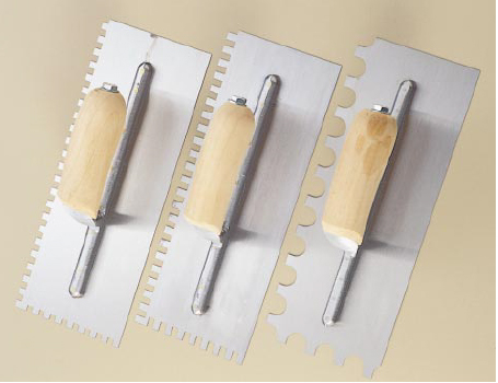

Notched trowels come in many configurations. Shown here, from left, are a 1/4x1/4-inch notch, for tiles up to 6 inches square, a 1/4x3/8-inch notch, for tiles up to 12 inches square, and a 3/4x9/16-inch U-notch, used for irregular handmade tiles.

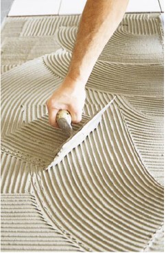

After applying the setting adhesive with the straight edge and bottom of the trowel, the tilesetter combs the setting bed with the trowel held at a 45-degree angle.

Notched trowels are used to spread tile adhesive, and while there are no hard-and-fast rules when choosing notch configurations, there are some guidelines. For standard wall and floor tile up to 6 inches square, a 1/4x1/4-inch notch configuration is recommended. For tiles up to 12 inches square, a 1/4x3/8-inch configuration will work.
Keep in mind that tile size is not the only factor to consider when choosing a trowel. Hand-formed tiles are often irregular, and will require a deeper notch (I’ve used a 3/4x9/16-inch U-notch trowel to set handmade Mexican pavers). When in doubt, choose a larger notch size. You may use a little more setting material, but your chances of avoiding a starved mortar bed (and thus poorly bonded tile) are better.
When setting tile 12 inches square (or larger), I’m careful to comb the setting bed in a single direction. This provides a clear path for air to escape as the tile is pushed down into the setting bed. When combing the setting bed, hold the trowel at a 45-degree angle.
One last note on trowel technique: Before laying down the full setting bed, a thin layer of adhesive should be worked into the substrate using the straight edge of the trowel, with ample pressure to work the adhesive into cracks and voids.
