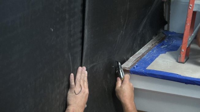

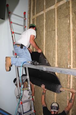

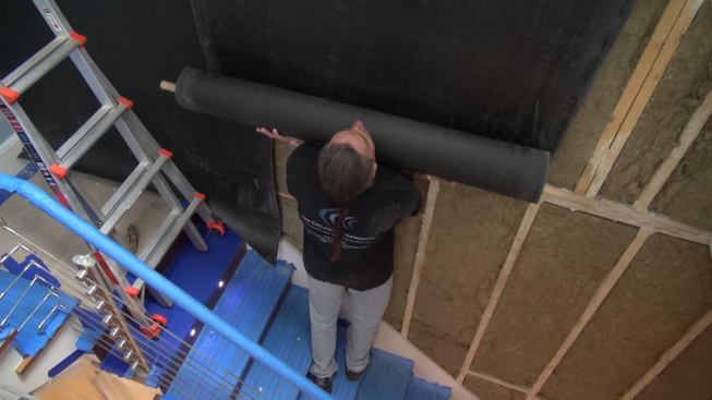

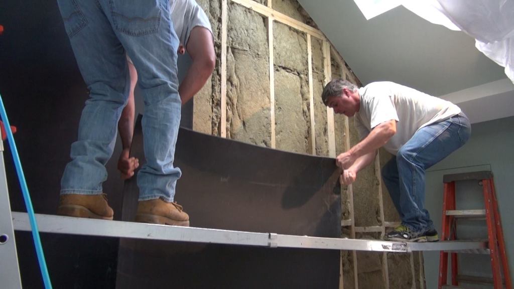

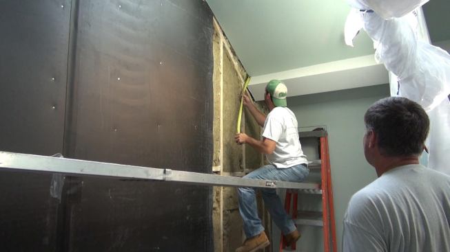

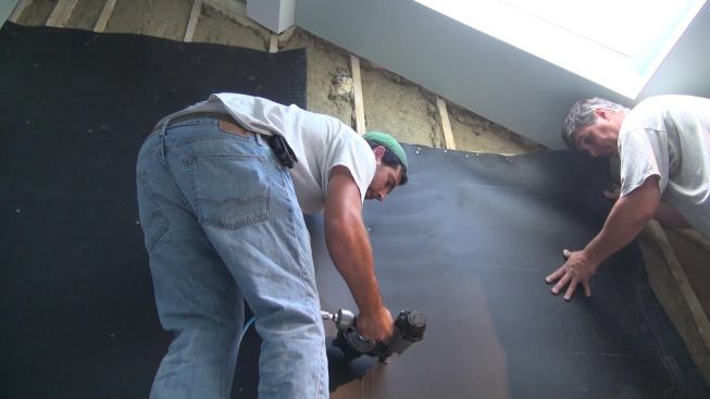

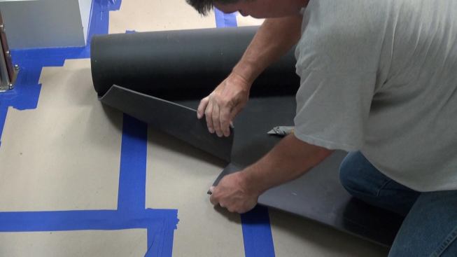

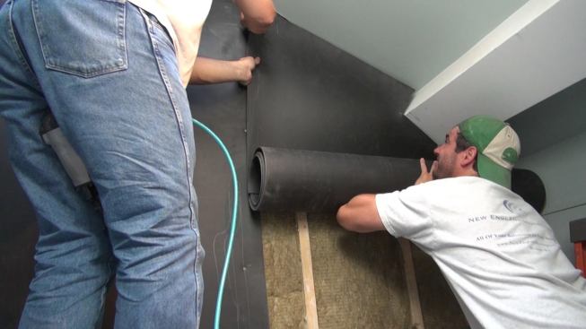

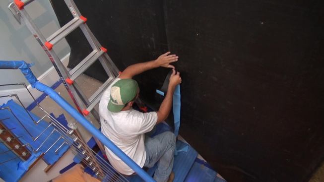

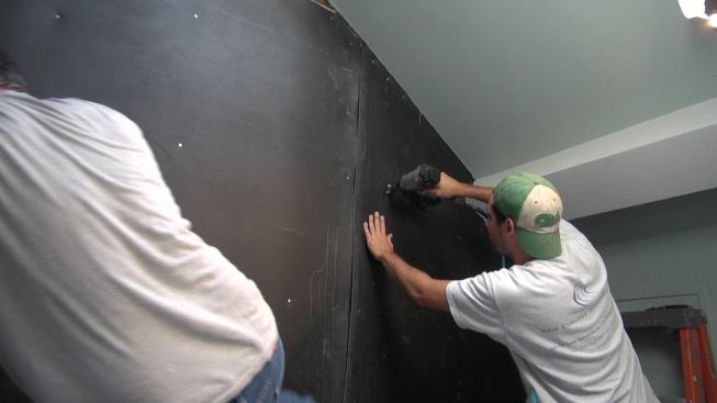

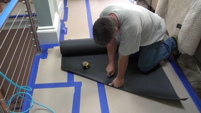

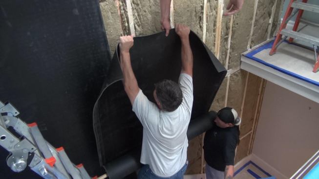

A crew from New England Soundproofing applies a sound-deadening, mass-loaded, sheet vinyl product called Sound Barrier HD to a party wall separating a condo stairwell from the unit next door. Materials like this vinyl and the special sound-absorbing rock-wool fiber insulation in the wall cavities can be used to absorb, deaden, and muffle sound vibrations from a variety of sources. Solutions are based on the nature of the sound source and the subjective perceptions of building occupants.

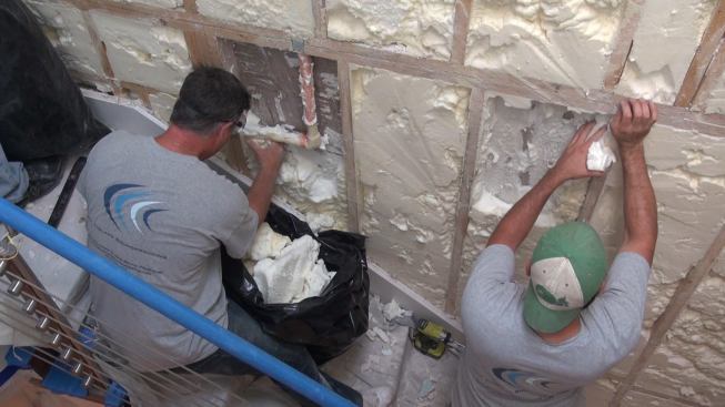

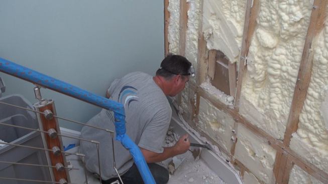

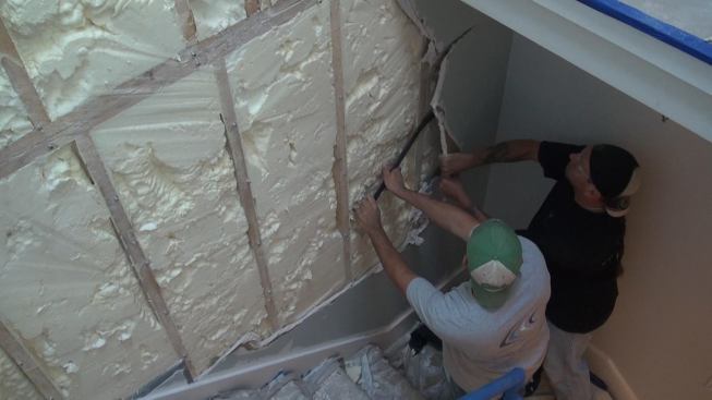

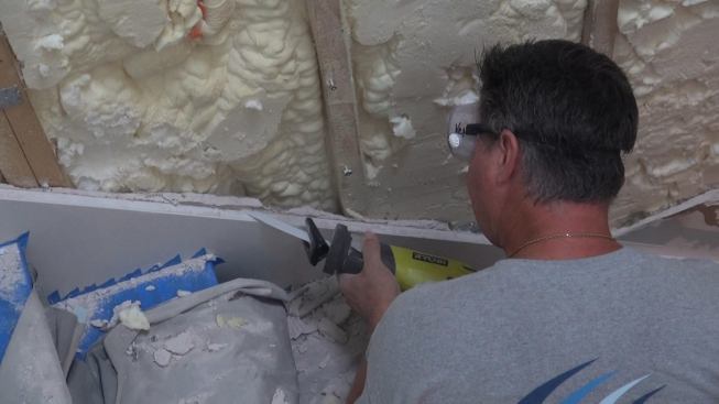

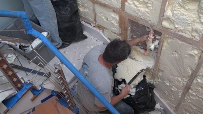

So Drago has to be careful about what he promises for results — especially when the circumstances, or the budget, may not allow him to deploy his full range of sound-deadening materials and methods. Take, for example, the stairwell shown in this week’s slideshow. The sound is coming into the stairwell from the condo next door. Drago’s plan was to strip off the existing drywall, remove rigid foam insulation, and install softer sound-absorbing rock wool insulation, plus a layer of noise-absorbing mass-loaded vinyl sheets, before putting drywall back up in the stairwell. If there were no stairs, the crew could go a step further, attaching standoff clips and metal channel to isolate the interior wallboard from the studs behind. But that would add thickness to the wall and there’s no room to do that in this situation without demolishing and rebuilding the stairs — which, understandably, is not in the budget.
The chosen solution will go a long way to resolving the issue, Drago says. It may fall short of perfect silence; but, he says, in most cases clients are satisfied that they’re getting what they paid for — as long as he’s careful to explain in advance.
