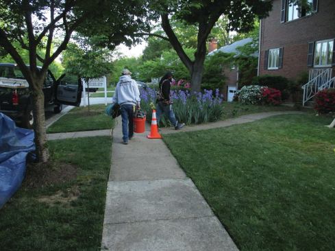

Before construction begins, we often stake out areas of the property that the homeowners have asked us to protect. For example, we use silt fencing or orange plastic construction fencing around the drip line of an apple tree in the yard to keep everyone away from the area. We are especially careful if we start a job in fall or winter—what might look like a pile of dead leaves could be a prized perennial garden.

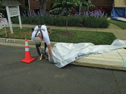

Material storage. We ask the homeowners beforehand where they want materials stored. Ideally, we store lumber inside the building, but when that’s not possible, we cover materials with 6-mil plastic sheeting or tarps secured with ropes or bungee cords.
It’s not a bad idea to check with the town about storing materials. On one job several years ago, a county inspector required us to move lumber that we’d stacked and covered in an alley that we had incorrectly assumed belonged to the homeowners.

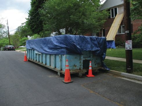

Roll-offs. We assist our roll-off drivers with placement of the dumpsters in an approved location and place traffic cones at the corners if the bins are left on the street. Check with the town: Some local municipalities might require a permit to leave a container on the street; others may require that it be tarped at the end of the day—which is a good idea anyway, as it prevents wind from blowing trash around. A tarp might also discourage neighbors from dumping unwanted debris after dark.
Deliveries. Heavy concrete trucks can crush a driveway faster than they can pour one. Think ahead about where the driver will want to unload and take any precautions you can.
Give some forethought to the most suitable place for washing out the concrete chute after the delivery. Most roll-out dumpsters are not watertight and should not be used if the drain water will leak off the site. If there isn’t a suitable place on site that will not drain onto another property or into a storm sewer, you may need to work with the ready-mix supplier to provide a washout bin.
It’s also important to know where to locate the portable toilet. I always try to be on site when it gets delivered so the driver puts it in a place the homeowner and I have agreed to.
Traffic. For the most part, our employees and the subs we use are courteous and respectful of the homeowner’s property. However, we sometimes define acceptable parking areas for their vehicles. You shouldn’t need to tell someone to use the walkways instead of wearing a path across the lawn, but a traffic cone can be an effective reminder.

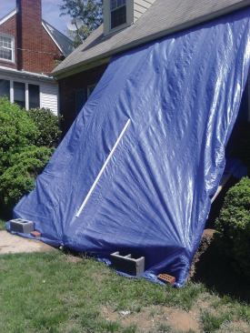

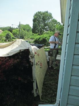

Tarping in. Until a job is dried in, keeping water out of the house’s interior is paramount. The most important thing we do for exterior protection is tarp the job thoroughly. We generally use standard blue tarps, which are inexpensive and sometimes last a few jobs, depending on how long they are in place.
Blue tarps will hold up well against heavy rains and wind only if they are installed correctly. The tarp’s edges must be placed over the roof peaks and along side walls and screwed down using furring strips—which can be made from ripped plywood and lumber—to keep edges tight. These strips prevent wind from causing the tarp to flap, which will quickly wear it out, or from getting underneath the tarp and ripping it. Placing old towels or insulation over sharp corners of the framing helps prevent tearing.

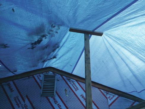

Water is heavy and will collect anywhere the tarp is not taut, so I try to anticipate where water is going to flow. Until the roof sheathing is installed, you may need to use temporary “ribs” or other members to prevent the tarp from drooping.
Sometimes, even these measures are not enough. Temporary “tent poles” may be needed to channel water out of trouble areas. Remember: Tarps aren’t a set-it-and-forget-it measure. Whenever it rains or is really windy, I closely monitor the tarps for leaks, pooling water, and torn areas.

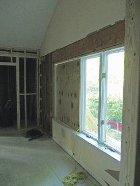

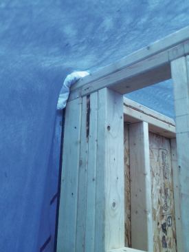

Window and door openings. Once we’ve completed the exterior framing, we leave window and door openings covered with the housewrap, which keeps rain and snow from getting into the house. And until the doors and windows are installed, we screw pieces of plywood over the rough openings from the inside to prevent falls and to keep out unwanted visitors.
Here are a few more points about doors and windows. Whenever we take delivery on a window order, I count all the insect screens and make sure they all arrived with the order. Then I store them in a garage or an attic, safely out of harm’s way.
On a recent job we did, an expensive mahogany front door was the main passageway into the home. I removed the mahogany door, stored it in a safe place, and made a temporary plywood door, complete with a lockset, that everyone could use until the job was just about complete.

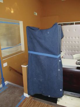

I like to use padded movers’ quilts to protect existing appliances and immovable built-ins and large pieces of furniture, and then cover them with plastic sheets. Do it correctly at the beginning of a job, and you won’t have to worry about it again.

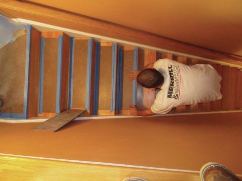

Staircases can get a lot of traffic. I cover carpeted stair runners with a roll of sticky-backed plastic sheeting that adheres to the carpet’s nap without leaving any residue when it’s removed. Blue painter’s tape holds the plastic to the edges of the stairs.
I cover wood treads with rips of inexpensive lauan plywood, also held in place with blue tape. You should also think about covering banisters and newel posts.

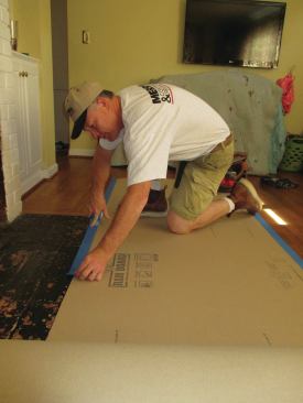

Full sheets of lauan work well to cover the entire area of a floor during the job. I duct-tape the seams to keep dust and grit from getting between the sheets.
Another good option for covering floors is Homasote. This panel stock is made from recycled cellulose, which helps absorb sound. And because the panels are thick and soft, they make an excellent cushion over finished floors, especially if we need to set up a table saw or staging in a room.
I’ve often used protection products made by Ram Board. Ram Board is 46-mil-thick 100% recycled paper that comes in 38-inch-wide, 100-foot-long rolls. You can spill a little paint or coffee on it, and it won’t soak through, but the material is permeable. According to the website, Ram Board can be laid over concrete floors without affecting the curing process.

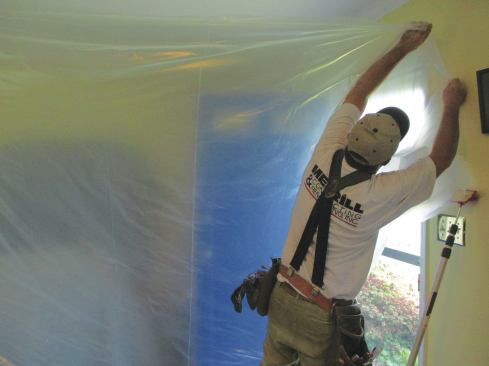

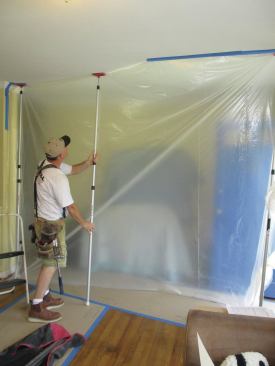

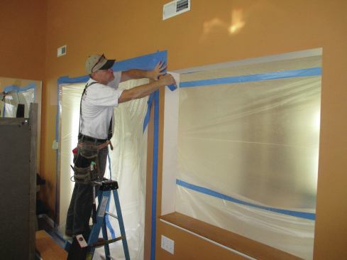

To cordon off rooms, we use Zip Wall, especially on wider openings. Temporary stud walls hung with plastic and painter’s tape work well, too, if an opening is going to be exposed for the length of a job.
I cover passageways with plastic sheeting held in place with painter’s tape. If a doorway will still get used, I’ll often use sheets on both sides of the opening and leave one side loose; that way, people can get through one side without completely exposing the other.

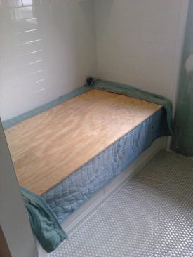

Bathtubs also need protection. If you just use plastic sheeting or even a moving blanket, it will sag and fall into the tub. I like to tape a moving blanket around the edge of the tub and drape it down the side, then cut a piece of 5/8-inch plywood to fit tightly over the blanket. Quarter-inch lauan won’t support the weight of the first guy who sits or stands on it.

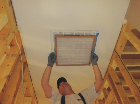

What you do about dust from drywall and floor sanding during a remodel can make or break your reputation with clients. You might have made it through the rest of the project without stomping on a single flower bed or putting even the smallest scratch on a wall, but if the whole house gets covered in fine dust from the drywallers or floor sanders, things can turn sour.
I spend at least five hours every week on jobsite protection of one type or another, and I’m especially careful to check and recheck everything before the dust storms begin. If the house has a forced-air system, I tape furnace filters over all the return ducts. Box fans propped in windows and doors can exhaust a lot of dust to the outdoors. The fans are also handy for pulling noxious fumes out of a building. Just recently I set up fans to get rid of the strong smell of a coating we were applying to basement walls.
