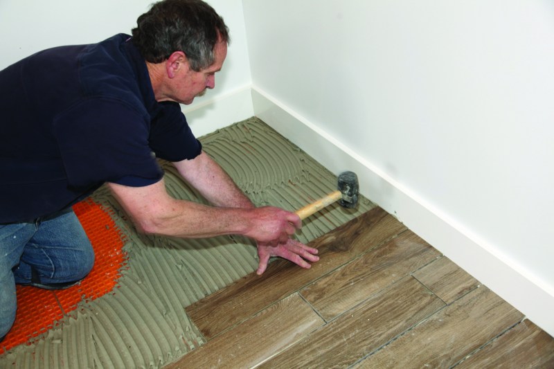

After combing the thinset out in one direction, press the tile into the thinset and tap with a rubber mallet.

The first step is using a trowel with the proper-size teeth for the tile you are installing. I always go over an area with the flat side of the trowel first to ensure a good bond with the substrate, and then comb a layer of thinset with the teeth, keeping the ridges going in one direction. Swirling or mixing the direction of the ridges can create voids that result in uneven coverage and support.

When I set each tile in place, I push it down with a slight side-to-side motion. Then I tap the tile down with a rubber mallet to prevent high corners or lippage. It’s a good idea to check the coverage as you progress through a project, so after installing a few tiles, slip a margin trowel under the edge of a tile and lift it. If the tile comes up too easily, you probably haven’t achieved proper coverage. After lifting the tile, check to be sure the thinset is adhering to most of the tile surface.
