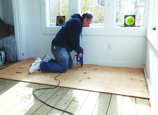

The author installs 1/2-inch plywood to reinforce the existing floor, then covers it with a layer of modified thinset.

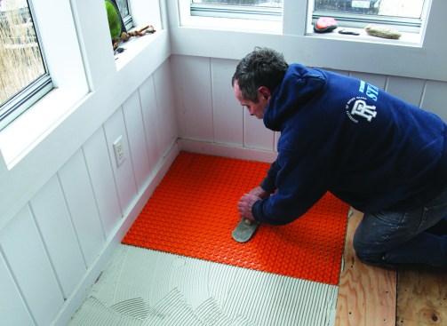

To embed the sheets of uncoupling membrane in the thinset, he applies pressure with a wooden float.

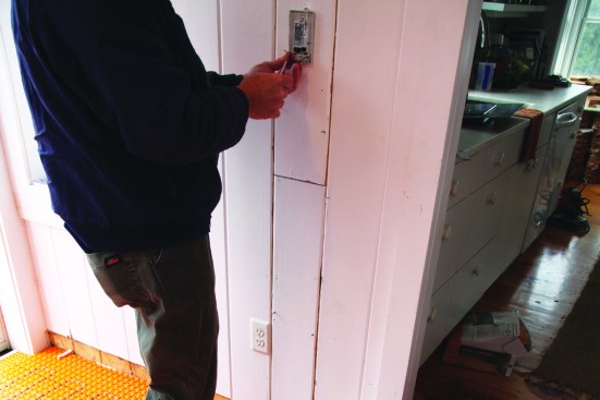

After testing the continuity of the heat mat and setting the sensors, the electrician wires the system to the house panel.

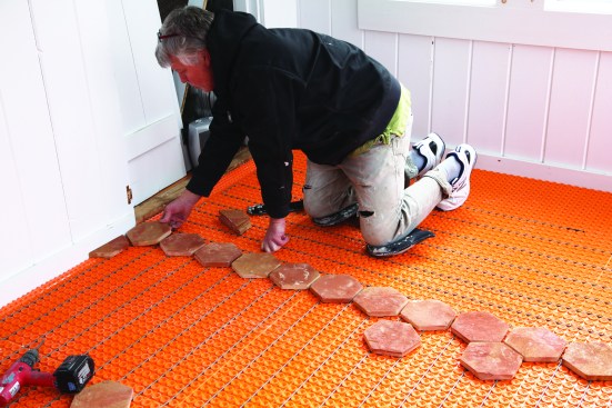

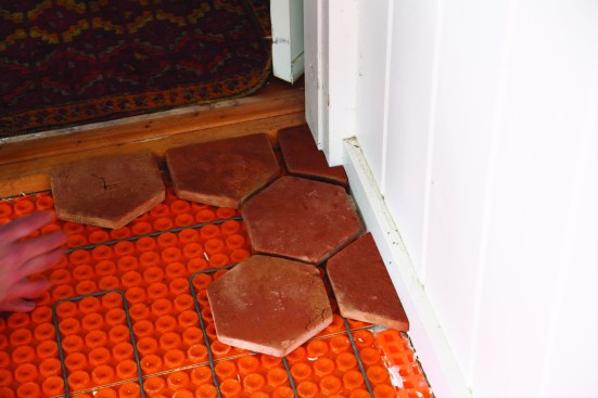

A crew member does a dry layout across the floor, adjusting the grout joints for an even layout.
To set the starting point for the installation, he scribes the tiles that will be installed at the main doorway into the house.

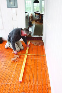

Before installing the tile, he measures from the wall to keep his installation guide—a long level—parallel with the wall.

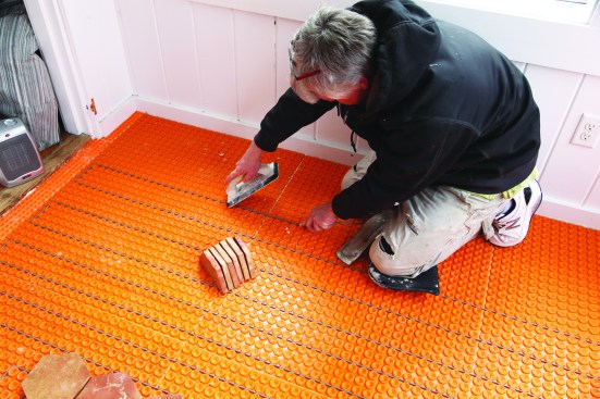

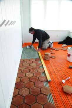

After spreading unmodified thinset with a 3/8-inch notched trowel, a crew member installs the tile using the level as a straightedge against the outermost course.

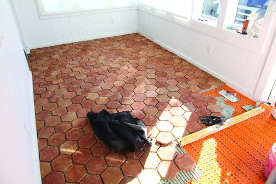

All cuts are made with a wet saw. Switching to a shorter straightedge, he works his way back across the room.

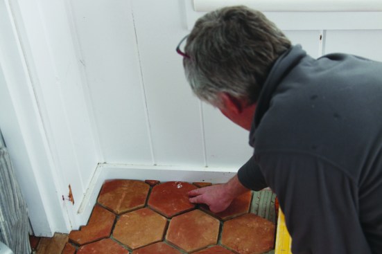

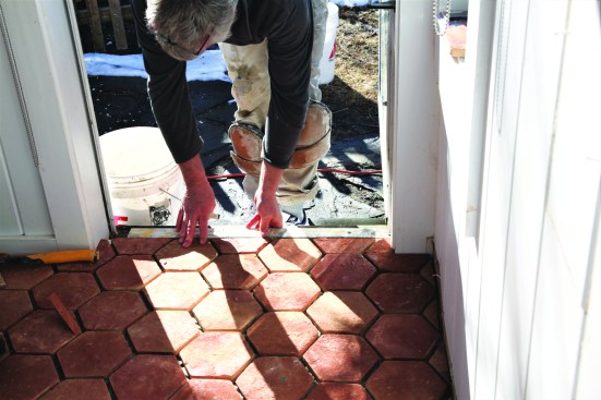

A short strip of wood aligns the last tiles at the entry door. A threshold will be installed later to protect the tile at the entry.

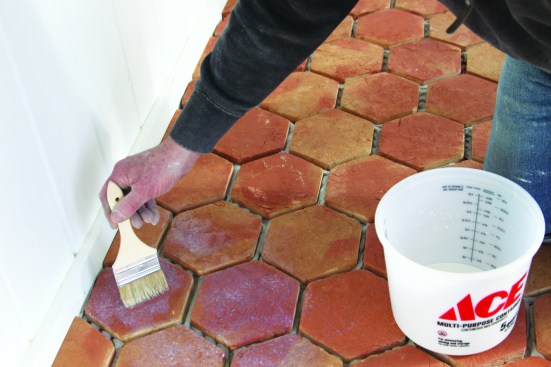

Even though the tile was presealed, the author applies waterbased sealant before grouting.

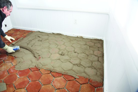

He fills the joints in the usual way, grouting about 20 square feet at a time.

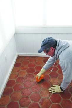

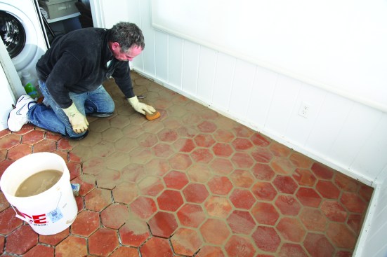

When the grout has set, he wipes the floor down twice with a sponge and water, starting with a fresh bucket of clean water each time. Because of the rough finish on the terra-cotta tiles, he doesn’t try to remove all of the grout haze at this point.

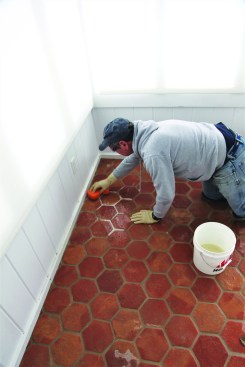

After letting the grout cure for a few days, the author cleans the remaining grout haze from the rough surface of the terra-cotta with a muriatic acid wash, which he uses only in extreme cases such as this. To protect his skin and eyes, the author wears heavy-duty gloves and safety glasses. After dampening the tile with clean water, he wipes a 10:1 water-to-acid solution over the tile, causing the grout areas to foam white as the acid cleans the residue from the tile.
Working with the acid solution in a small area, he thoroughly soaks the tile with fresh clean water, letting the water puddle on the tile to neutralize any residual acid before he soaks up the solution and wipes off the tile with a clean sponge. He later returned and sealed the whole floor.
