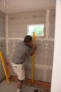

The strongest visual element in the shower is the window with the niche centered below it. So the side to side layout for the tile is taken from the center of the window. Here I drew a plumb line down from the center of the window for one of the primary layout lines.

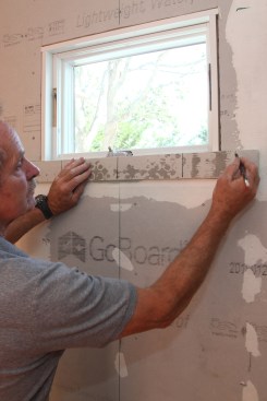

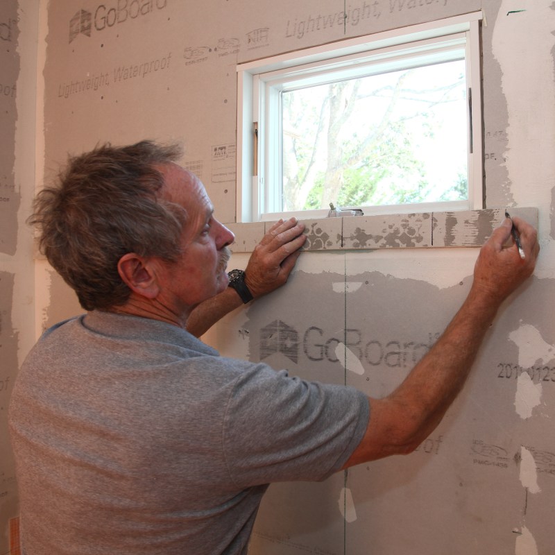

To check the horizontal layout I made a story board from a wall board scrap. I set the story board on the layout line and check to see where the layout falls beside the window.

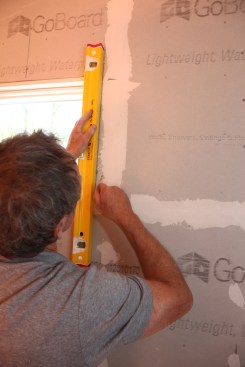

After marking the layout next to the window, I draw a plumb line along the side of the window to help guide the tile installation at that point.
