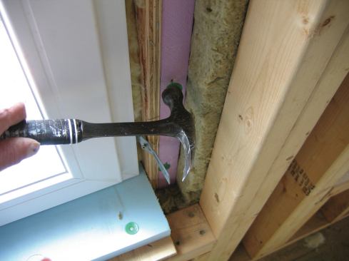

The advantage of a double-stud wall is it reduces a lot of the thermal bridging found in standard stud construction, and I wanted to maintain that break as much as possible with the window detailing.

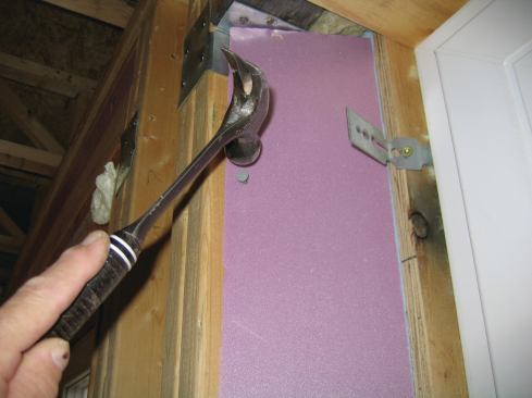

I first filled the space between the spreaders at the top and bottom of the windows with 3/4-inch rigid insulation after the windows were set in place. I also placed 1 1/2-by-2-inch rigid insulation to fill voids where the Roxul insulation had been held back. Next, I cut and fit 1 1/2-inch rigid insulation on top of the spreaders at the bottom of the windows. I held this back 2 inches from the inside edge. On each flared side, I angle-ripped 3/4-inch rigid insulation and tacked it in place, keeping it back from the plywood bucks.
I wanted a good nail base for the drywall, so I installed 1 1/2-by-2-inch nailers to the front edge of the sill to provide a good screw base for the interior drywall, and at the top of the window, stapled 5/8-inch CDX with the ends cut to the required 30-degree flare.
For the flared sides, I ripped 5/8-inch plywood with parallel 30-degree bevels along each long edge and stapled these off with a pneumatic stapler. I checked often to maintain a consistent reveal. Any plywood that protruded beyond the framing was hit with a power planer.

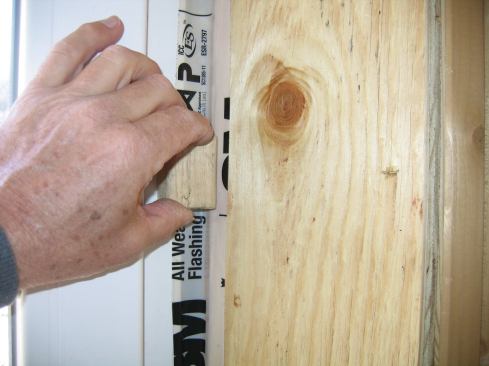

Before installing drywall, I air-sealed the windows by taping the corner between the window unit and the plywood surround using 3M’s All Weather Flashing Tape. This tape is 2 inches wide with a slit paper backing that allowed me to tape one side of the intersection before peeling off the backing and taping the other side. A scrap block pushed the tape into the intersections and smoothed out possible wrinkles. And before covering over everything with drywall, I squirted canned low-expanding foam into any voids.

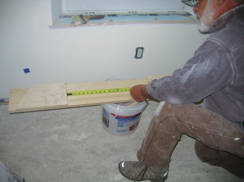

As with the side flares, there was some discrepancy in the width of the rough sills, so I cut them all to the width of the widest sill and trimmed them to fit each sill individually.
I expected some variation in length, too, so I made a template with 12-inch scraps for the left and right side of the sill that matched the flare angle. I laid these in place on the sill, then measured the distance between them. To find the finish length of each sill, I transferred the angled scraps to a piece of Baltic birch, separated by the measured distance between them.
After cutting the sills to length, I temporarily set the sill in place and measured what I’d need to rip it to be flush to the drywall.
