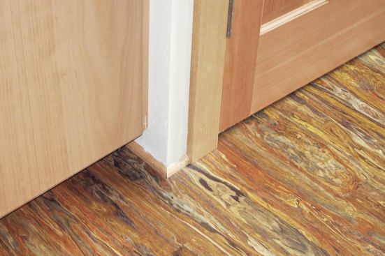

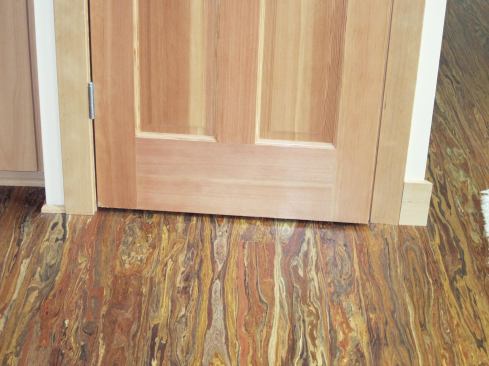

Flattening the Floor
The plans called for replacing about 600 square feet of existing carpet and sheet vinyl with new flooring. When we finally tore off the original flooring, we found some significant high spots in the subfloor, with variations of 3/8 inch or more. This might not have been an issue with new vinyl, but the homeowners had selected a tongue-and-groove bamboo flooring, and I knew the irregularities in the subfloor would telegraph right through.
We found that the worst of the high spots were along a floor beam, so I first tried cutting a little off the wood post that supported the beam to see if it would drop down. As I feared, it didn’t work, so we shimmed the beam back to its original position, set all the subfloor nails we could find, and knocked down the high areas of the 2-inch-thick T&G subfloor with a power plane. (We did miss a few nails with the nail set, but we had no trouble finding them with the plane.) The flooring sub then took care of some remaining low spots with leveling compound. Laying the flooring turned out to be troublesome, too. The 9/16-inch material was meant to be blind-nailed through the tongues, but it was so dense the flooring contractor gave up on nailing and glued the material down.
Cost ? One and a half hours of my time, and a set of plane blades. I don’t know if there was an extra charge for gluing rather than nailing the floor, since the owner contracted directly with the flooring company.

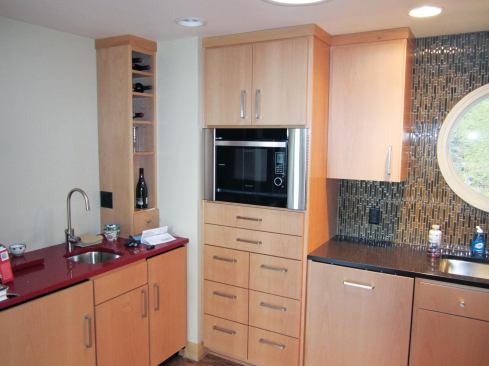

Giant Cabinets, Big Backaches

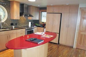

The owner had contracted with the cabinet­maker directly, so we had less input on this part of the project than we otherwise would have. And even though the problems we ran into weren’t our fault, finding the solutions was mostly up to us. The cabinet above the refrigerator, for example, was built with a full-length side panel running down to the floor on the left of the fridge. The unit would fit through the door only in horizontal position, but when the time came to install it, we realized it was too tall to stand upright. By sheer luck, there was a skylight well in the ceiling that gave us just enough space to accommodate the diagonal height as we picked up the cabinet.
The microwave and pantry base cabinets were also so large that it took four men to carry them into the house, even after we had removed the doors and drawers. The integral toekicks compounded the problem. I generally ask cabinet­makers to provide separate bases and kicks — it’s easier to level a 10-pound toekick than a 150-pound base cabinet — but, again, I wasn’t dealing with the cabinetmaker directly on this project.
Cost ? For the refrigerator upper cabinet, a half-hour each for me and my carpenter. No significant extra time for moving the cabinets, just some worry at night about whether anyone had hurt his back (a real issue for middle-aged builders).

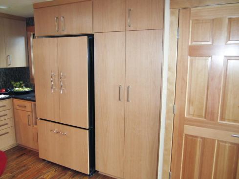

An Outstanding Panel

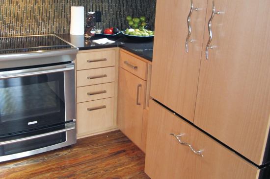

High-end refrigerators seem to get bigger every year, and the model the customer finally selected was several inches deeper than the cabinetmaker had expected. As a result, the wood panels on the face of the fridge extend several inches beyond the surrounding panels. If we’d known about this in time, we could have stolen some space from behind the wall and framed a recess for the fridge to fit into. But given that the house was none too big to begin with, the customers preferred to stick with their refrigerator selection. They don’t mind the discrepancy in the face of the cabinets, though the architect and I agree this was the biggest mistake on the entire project.
Cost ? None.

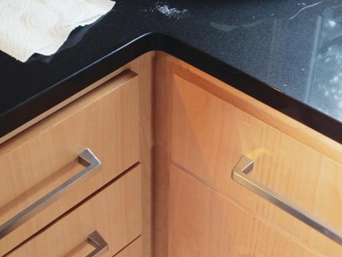

Corner Clearances
One corner of the base cabinet run was a trifecta of conflicts. The first had to do with the drawers on either side of the corner. These slid by each other easily until we installed the pulls; fortunately there was just enough side-to-side adjustment in the slides to gain the necessary clearance.
The second was a conflict between one of the corner drawers and the range, which prevents the drawer from opening fully. There was no good solution, but because the restriction is only a couple of inches, the owners find they can live with it.

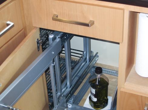

The extra depth of the refrigerator created another problem. The inside corner base cabinet to the right of the range contains baskets designed to pull out and then to the right, to give access to an inner basket. The problem was that when the hardware was pulled to the right, it ran into the projecting refrigerator panel.
This was the cabinetmaker’s mistake, so he had a metal shop cut down the outer basket to fit. We made the necessary adjustments on site to reinstall the hardware and get it to work.
Cost ? The cabinetmaker spent hours figuring out what to do and incurred some fabrication cost, but my time was negligible.

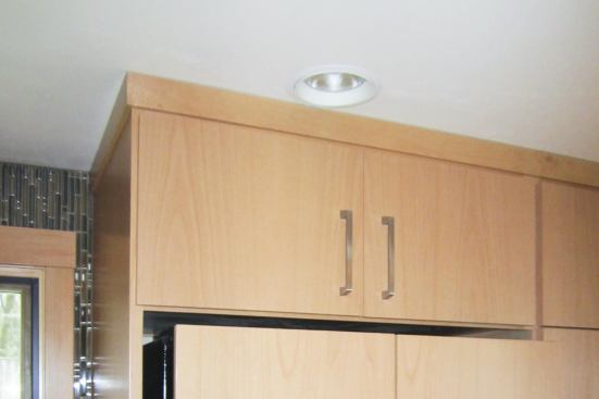

Trimming the Trim Ring
Although we thought we’d left plenty of space between the recessed lights and the walls, we forgot to allow for the 3/4-inch-thick trim around the top of the refrigerator cabinet. Rather than moving the fixture itself and having to patch the smooth plastered ceiling, I ripped the trim down to about 7/16 inch thick and cut a very slight amount off its edge to allow it to fit into place. Though it doesn’t jump out at you, I’m not completely happy with this solution. The clients are happy with it, however.
Cost ? One hour.

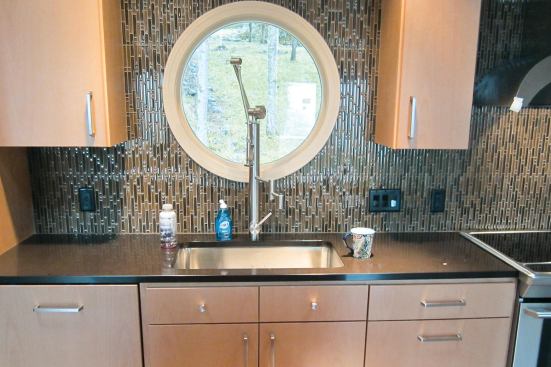

Saved By a Single Bowl
The kitchen sink and its high-end faucet were both intended to be centered on the gap between the drawer fronts below and the round window behind. Unfortunately, there was a slight discrepancy in the various dimensions: If we had centered the faucet on the window and sink, the drawer gap would have been visibly out of line with everything else. We solved the problem by moving the faucet ever so slightly off-center in relation to the sink, bringing it closer to the drawer-front gap. It’s good the customers had chosen a single-bowl sink; the discrepancy would have been much more visible against a double sink with bowls of equal size.
Cost ? A half-hour.

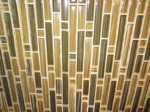

Tiny Tile Issues
The owner chose glass tile for the back­splash, and each tile was only 5/8 inch wide. I realized in advance that laying out the electrical boxes was going to be more critical than usual, with all those vertical grout lines to contend with and no practical way to cut such tiny tiles. It may sound obsessive, but I planned the exact side-to-side location of each box, installed blocking as needed, and mounted the boxes myself with a 1/16-inch tolerance side to side. The tile installer was happy.
Cost ? Two hours.

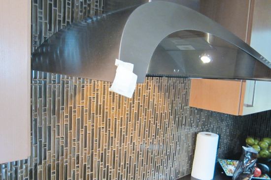

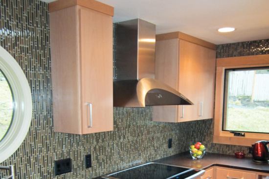

Range Hood Too Tall
The high-end range hood mounts to the wall on a concealed bracket, with a telescoping two-part rectangular chase above it that contains the electrical components and exhaust duct. Because it’s made for an 8-foot ceiling but we only had 7 feet 8 inches, the only way to make it work was to shorten the rectangular chase — a task we farmed out to a local sheet-metal shop. They did a neat job, and the modified unit went in fine.
Unfortunately, the sharply angled corners of the hood itself have proven to be a liability. My carpenter, the electrician, and I all managed to drive these corners at least a little way into our heads while installing the unit, and the homeowners have had the same problem. This is really a design defect, and there are only two possible solutions — throw the expensive item away and install a different one, or learn to avoid the corners. The home­owners have opted for the second course.
Another issue with the hood is that it has a maximum volume of 450 cfm. A local code provision requires that makeup air be provided for any hood that moves more than 400 cfm. It’s a brand-new requirement, and so far no one seems to know how to meet it in practice. It was apparently new to our inspector, too, because he didn’t call us on it.
Cost ? One hour of my time, $45 for the sheet-metal work.
