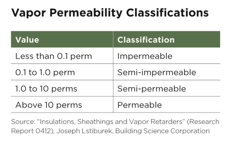

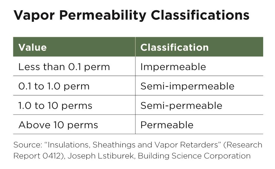

Felt’s perm rating varies. Dry, #15 felt is rated at 6 perms, #30 felt at 5 perms. When wet, however, felt’s permeability increases to between 20 and 60 perms, according to Martin Holladay of TheEnergyNerd.com. A permeable underlayment may be a good thing, then, for applications such as a roof over an unvented attic or cathedral ceiling, for traditional installations of cedar shake and shingle roofs — or for a leaky roof.
Whether a permeable underlayment offers a benefit for the most common home roof assemblies is questionable, however, according to a white paper sponsored by Owens-Corning, co-authored by Joseph Lstiburek of Building Science Corporation. Its title, “Vapor Permeability Provides No Performance Benefit for Roofing Underlayments in Ventilated Attics,” tells the other side of the story. Test results provided in the paper indicate that layers of asphalt shingles built up in a typical installation form an impermeable barrier that won’t allow moisture to escape even if the underlayment can breathe. — M.C.
