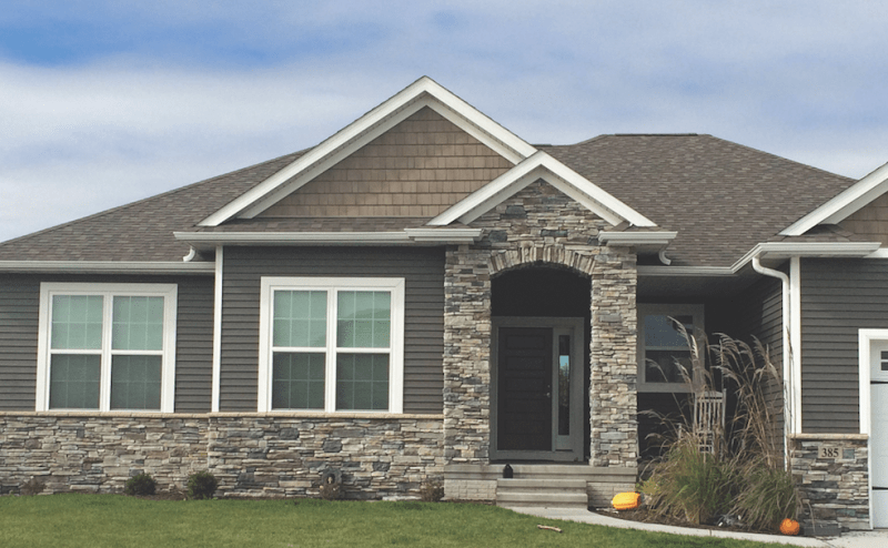

The latest Cost vs. Value report shows that adding manufactured stone to the bottom third of a façade, and outlining the front entry, has a high return on investment. But if it's done wrong, that investment can quickly turn into a huge liability.

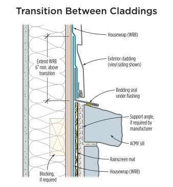

The problem goes beyond the lack of an effective WRB behind the stone. Typically, I also find no flashings at the transition between the siding on the upper part of the walls and the stone veneer “waistband”; poor flashings near windows; and no effective drainage from behind the stone.
Case in point: On a recent home with a stone veneer waistband, the contractor simply slathered mortar onto the existing single layer of housewrap and began applying the stone. He didn’t provide a flashing detail at the transition, so any water draining from the upper vinyl-sided walls hit a stone dam and traveled in three ways:
  • Some of the water flowed down the crack between the housewrap and the stone. There was no flashing here, just the vinyl starter strip.
  • Some water flowed down the exterior, soaked through the stone, passed through the housewrap by capillary action, and soaked the OSB sheathing, where we measured 55% moisture content.
  • And some of the water flowed around the window flange and down the wall studs.
Had the wall detail allowed for it, the water should have drained all the way to the bottom of the wall, where it should have been allowed to escape and drain away from the building. To make this happen, the wall needs a continuous drainage plane behind the vinyl that drains out of the wall via a through-wall flashing above the stone sill. Vinyl is a loose and forgiving cladding, and you can usually get away with one layer of housewrap, as long as it laps over the top of the through-wall flashing, as shown in the illustration at left.

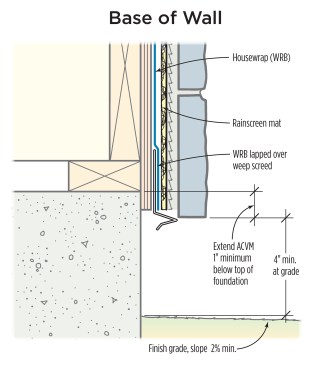

Behind the stone, you need much more than just housewrap. Most manufactured stone veneer should be detailed like a stucco wall. (The exception is a mortarless installation that is screwed in place and includes built-in standoffs that create a drainage space behind the stone.) There are a number of manufacturers that provide rainscreen mats or drainable housewraps that are designed to be installed over a conventional housewrap. I prefer using the product line from Masonry Technology (mtidry.com) because it offers a full array of weeps, flashings, and drainage materials.
If a rainscreen mat is not used, at the very least you need a new layer of black paper over the existing housewrap, or two layers of black paper, as is required by code for an exterior lath and plaster assembly. The housewrap and rainscreen mat should lap over the foundation sill and terminate at the bottom of the wall at a weep screed positioned at least 4 inches above grade.
