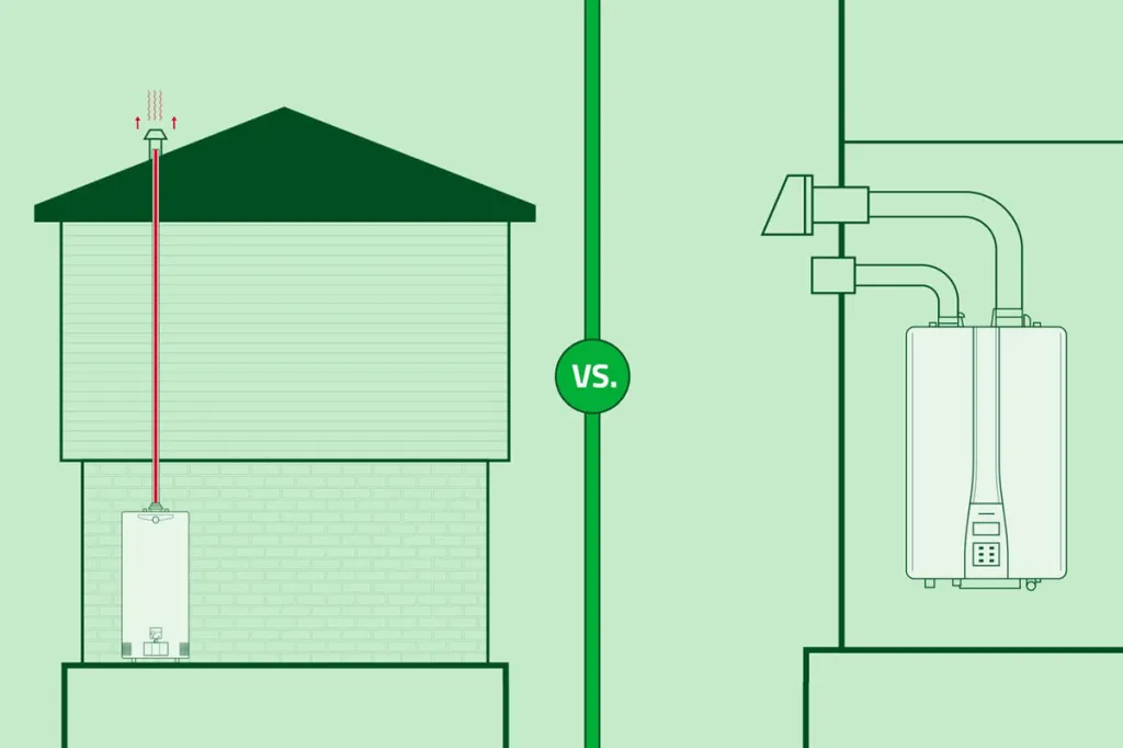

1. You don’t have to vent through the roof.
While traditional tank-style water heaters had to use B-vent to send exhaust through the roof of the home, tankless water heaters can vent through a side wall as well because the combustion fan blows exhaust from the units horizontally. That option can save builders and contractors significantly on material costs and installation time.
