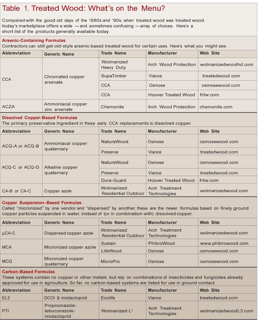

This new policy set the stage for an ongoing parade of new treated-wood products and formulas (see table, facing page). First up was ACQ — ammoniacal copper quaternary or (depending on the carrier used) alkaline copper quaternary. This formula keeps the relatively benign copper but replaces the arsenic and chromium co-biocides with a quaternary compound, or “quat.”
Compared with arsenic, quat is pretty mild stuff; it’s basically a sanitizing soap based on ammonia. Quats are a universal ingredient in shampoo, for example. And the typical quat used in ACQ, known as “DDAC,” for didecyl dimethyl ammonium chloride, is also an active ingredient in household products like Mr. Clean sanitary wipes and Febreze antimicrobial fabric freshener.
The other early entry was copper azole, or CA — which, like ACQ, has copper as the primary fungicide and insecticide, but uses carbon-based “azole” compounds called tebuconazole and propiconazole to do the job of arsenic. The azoles are pesticides, widely used in agriculture to control insects and fungi. Unlike arsenic, azoles are approved by the EPA for use on food crops. Seed treating is a common use for azoles; in California, the biggest users of tebuconazole are grape growers who spray it on their plants.

In response to the increased corrosion and other problems associated with ACQ and CA, within just four years of their introduction these second-generation formulations were largely replaced by a newer generation of “micronized” — or “dispersed” — formulas with names like micronized copper azole (MCA), micronized copper quat (MCQ), and dispersed copper azole (µCA). As of 2008, says Freeman, MCA, MCQ, and µCA accounted for 80 percent of the residential market, with ACQ and CA squeezed down to 20 percent or less.
These new third-generation formulas contain copper in the form of very finely ground particles, rather than in dissolved form. They don’t need the nitrogen-rich amine carrier, and because they are less prone to leaching, they can be treated with less total copper and still maintain adequate long-term concentrations. Manufacturers also claim that these formulas are less corrosive to fasteners. Osmose, for instance, says that its SmartSense treated wood with MicroPro, a micronized copper quaternary formula, “exhibits corrosion rates on metal products similar to CCA pressure-treated wood and untreated wood.”
