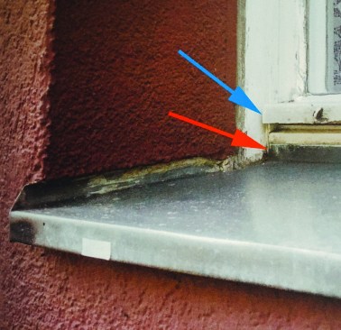

Water details in masonry buildings. Caulk alone doesn't work.

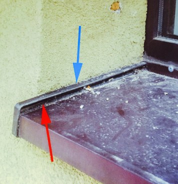

This sill has an end dam. Better, but water can still leak behind it.

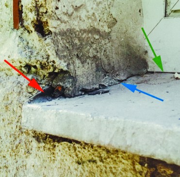

On this end dam, the stucco covering it will wick water.

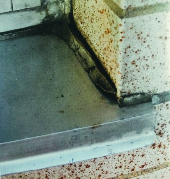

The last option is the best but is still not perfect. See why?

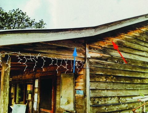

Buildings Don’t Lie is peppered with picture quizzes. This one points to the siding under the eaves of the porch (blue arrow) and asks why it is more weathered than the siding on the main house (red arrow). No spoilers here; you’ll have to buy the book.
