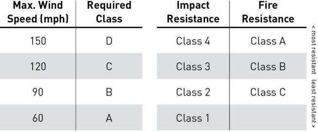

Shingles are tested for resistance to wind, fire, impact, tearing and algae growth.
  • Wind: ARMA (Asphalt Roofing Manufacturers Association) has developed a classification system for selecting shingles based on the wind zone designation for a specific region.
  • Fire: Most laminated asphalt shingles carry a Class A fire rating; most strip shingles carry a Class C rating.
  • Impact: UL 2218 ranks shingles in four classes, from least resistant (Class1) to damage from hail and flying debris, to most resistant (Class 4).
  • Tear Resistance: Use only ASTM D3462 rated shingles.
  • Algae: Shingles with “–AR” appended to the product name resist staining from organic growth for eight to 15 years.

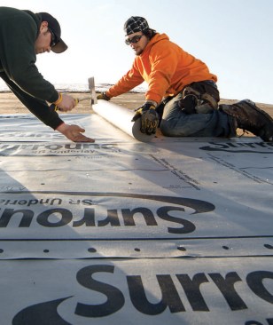

Synthetic Underlayment
Synthetic underlayments have several advantages over felt: They’re stronger and lighter. They come in wider, longer rolls that cover the roof faster. They don’t soften or wrinkle when exposed to moisture. They’re more tear-resistant. They resist expansion and contraction with temperature cycling, so they wrinkle and buckle less severely than felts, and have less tearing around fasteners. And their UV coating means they can be left exposed to sunlight for up to a year.

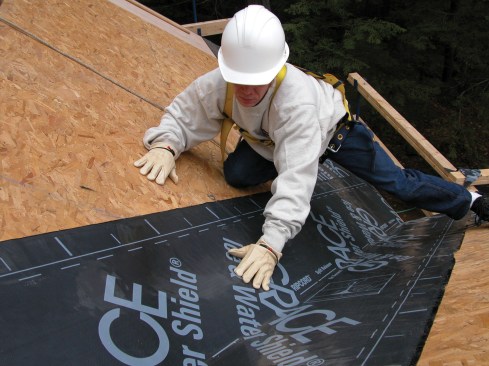

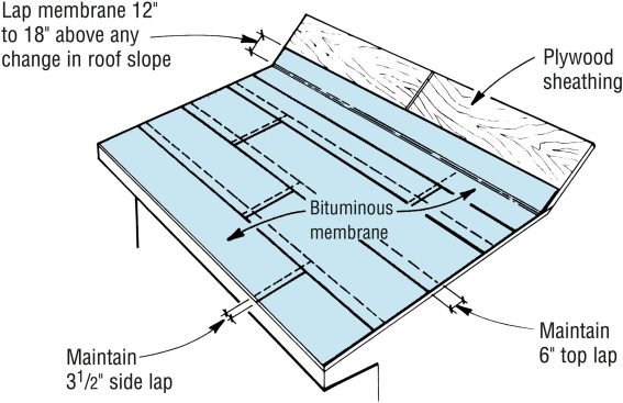

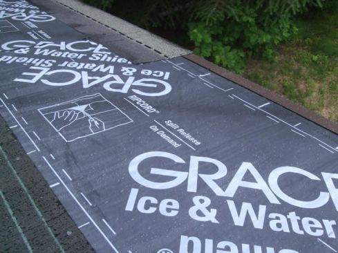

Self-Adhering Membranes
W.R. Grace and Co
Peel-and-stick membranes have a self-healing adhesive backing. Because of their high cost, these products tend to be used mostly in “problem areas,” such as eaves and valleys, and in combination with metal flashing at chimneys, vents, and other roof penetrations. The exception is on roofs with extremely low slopes.
In snowy regions, slopes below 2:12 should be waterproofed with a peel-and-stick bituminous membrane. Horizontal laps (between succeeding courses) should be at least 6 in. wide; vertical laps (those between adjacent pieces in the same course) should be at least 3 1/2 in.Use shingles that are labeled “wind-resistant,” or use standard asphalt shingles and put a dab of asphalt adhesive cement beneath each tab.

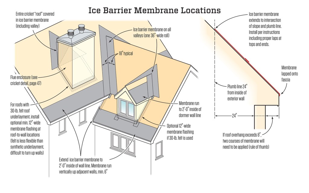

Protection from Ice Dams
Some codes in Northern areas require that the membrane extend from the eave to a point 2-feet inboard of the outer wall, to protect against ice dams.
However, an ice dam can loosen the membrane at the edge of the roof, allowing water to work its way up and under the drip edge. A double membrane creates a backup. Place a 9-inch wide strip of peel-and-stick membrane on the sheathing and lap it over the edge of the roof to the fascia board. Then install the drip edge and place a full-width sheet of membrane over it, followed by the underlayment.

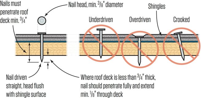

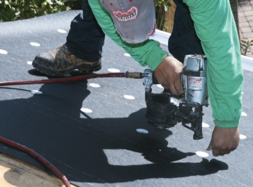

Nailing Asphalt Shingles
Most blow-offs are caused by poorly applied, or badly chosen, fasteners. Nails hold better than staples and are always a better choice.
Nailing
To prevent blow offs use only wide-head roofing nails and drive them straight and flush. The nail head must bear tightly against the shingle without penetrating it – any more or less and it will loosen over time. The nail must also penetrate the roof deck 3/4 in. To prevent blow-offs, drive nails straight and flush. Seal an over-driven nail head with roof cement and drive a new nail next to it. For a mis-driven, angled nail, drive the head flush, then repair it as you would an over-driven nail.

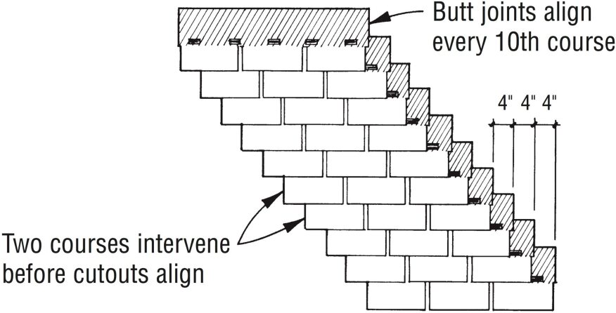

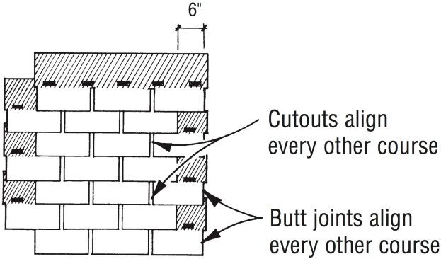

Offset Patterns
How well three-tab shingles hold up over time depends to some degree on the patterns used to lay them.
Offsets for Three-Tab Shingles
Although many customers prefer to see the cutouts aligned on the roof, this directs runoff into channels that erode the shingle surface.

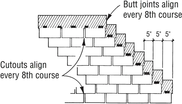

There are four basic patterns to laying out three-tab shingles: straight-up method, half-pattern, 4-in. offset, and 5-in. offset. The 5-in.-offset pattern provides the best all-around protection.
Alignment Guides. Most shingles include 1/2-in. alignment slits across the top edge and half-slots along the edges. Use these to line up adjacent shingles and successive courses. In addition, shadow marks may run the length of each shingle near the top of the slots. These are meant as an aid to horizontal alignment.
The straight-up method of laying shingles offsets alternating courses 6 in. from a vertical line up the roof (half a tab width for metric shingles). The alignment of butt joints and cutouts in every other course, however, can cause premature weathering of surface granules.
A half pattern (also called half-tab or sixes) staggers each course with a 6-in. offset (half a tab width for metric shingles). Butt joints are better protected from water migrating horizontally, but cutouts still align every other course.
A 4-in. offset keeps cutouts separated by two courses, and butt joints align every ten courses. But the short lap doesn’t provide enough protection in wet climates, or in areas with severe freeze-thaw cycles.
A 5-in. offset provides the best all-around protection. Both the cutouts and the butt joints align only every eight courses, so runoff is less likely to cut channels into the shingle granules. It also hides shingle irregularities as well.
