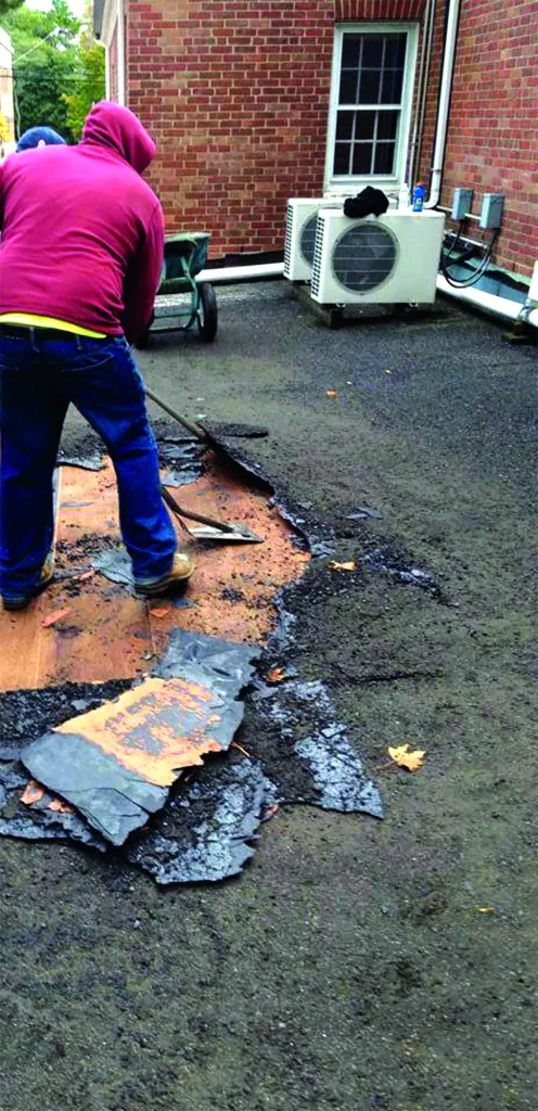

There are two types of built-up roofing (BUR): asphalt and pitch. Here, a tear-off crew begins work on a circa 1950s “pitch” roof.
Jim Bennette

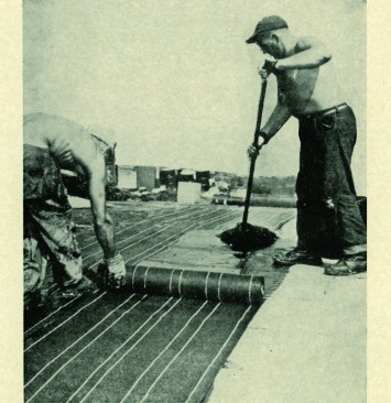

A tar-and gravel crew installing a pitch roof. There were three main guys on an install crew: a mop man, a paper setter, and a kettle man. The mop man ran the roof and skillfully glided the mop (pitch mops were twice as heavy as asphalt mops); the paper setter followed his lead; and the kettle man arrived on site early to start the kettle and kept it full during the day. Apprentices lugged the “hot” from the kettle to the carts.
James McCawley, Roofing: Estimating-Applying-Repairing
