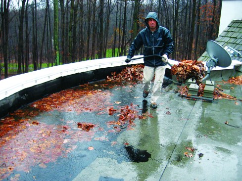

In one recent case, not only were parts of the roof dead flat, but it had only tiny, 5-inch-by-5-inch scuppers through the parapet wall. (You can’t see this parapet roof from anywhere on the property, and there was no functional or design reason to have a parapet wall there, but it was on the original plans.)
On this roof, the roofing was a single-layer modified bitumen that wasn’t maintained well. Because there wasn’t enough slope, water lay on the roof and froze in winter, creating havoc for the seams. There were patches all over it. In fact, this roof was so bad, the roofer had left the bucket of asphalt cement and a trowel up there for the next time he needed to fix it.
This time, we got the call during a rainstorm, and we found about 35 bushels of leaves on the roof, along with 2 inches of water. Once those tiny scuppers filled up with leaves, it was impossible for water to drain off the roof.

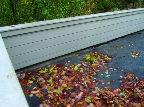

SCUPPERS

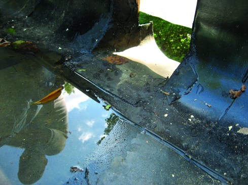

When scuppers are flashed-in correctly, they have several layers. Even if the roof is sloped, the scupper flashing can create a dam that holds water. If you’re the one sloping the roof, adding pitch here can help the water run off, but we often need to work with what’s already there.
To allow for good workmanship and to keep leaves from building up and blocking them, scuppers need to be at least 8 inches tall and about 12 inches wide. It’s also critical to mount the receptors as low as possible on the outside of the parapet.
When a receptor is mounted above the roof level, you end up with a dam when the receptor fills up with leaves, regardless of how big the scupper is. The receptor needs to be mounted low enough so that when it’s full of leaves, water pours out over the top edge instead of backing up across the roof.

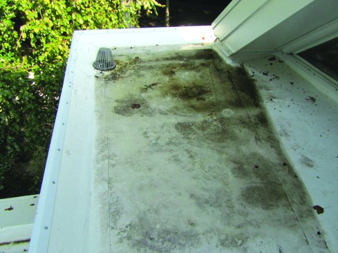

DRAINS

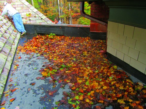

We see similar problems with drains. Even with a leaf basket over the drain, leaves still collect around its base, creating a dam that prevents water from draining. As a result, a big puddle forms all the way across the roof, which is exactly what you’re trying to avoid.

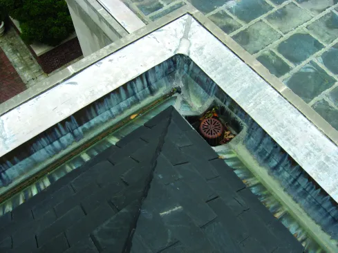

BUILT-IN GUTTERS

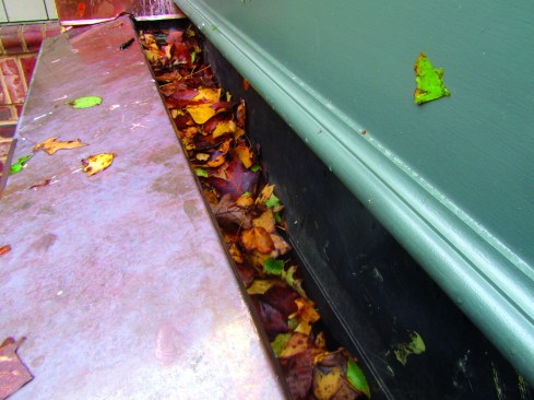

Built-in gutters are good only at collecting leaves. I view them as being a worse version of a drain.
It’s difficult to fit a proper drain in a gutter. It can be done, of course, but in a remodeling situation, we are usually stuck with the existing drain locations, and they often are in the wrong place for expansion joints to properly manage thermal expansion of the metal. Even with good workmanship, the metal expands and contracts, and if the movement joints aren’t in the right places, the seams eventually rip open and leak.
On one of our jobs, the drain was built into the corner, and there was no room for a clamp ring and no room in there to solder. And the drain was positioned exactly where an expansion joint should have been. I don’t think there was any good solution for that one—other than putting in another drain, running two stories down through a finished house.

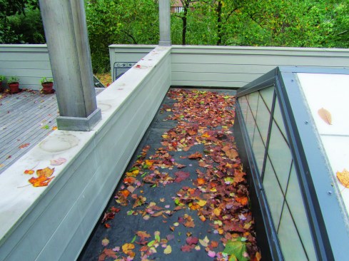

OPEN EDGE
The scupper shown here was an attempt to make a scupper large enough that it would not clog. This one is only about 4 inches tall, however. It took longer to clog than the tiny ones on the house shown previously. But it eventually did after the landscaper—the only one who knew to clean off the leaves from this roof area—was fired. Making it larger—this one was about 4 feet wide—was a step in the right direction, but it wasn’t enough. It needed to be either higher or much, much wider.
It is possible to make a completely open edge, but still have a parapet wall. On this example, we installed the parapet wall on posts. The wall ends about 4 inches above the roof, providing a continuous space for drainage. It’s easier to detail—you don’t have all the complex origami that flashing in a conventional scupper requires—and it’s much harder to clog. You can’t really see it from outside, because the gutter hides the view of the opening. If you need to have a parapet wall, I think that is the way to do it.

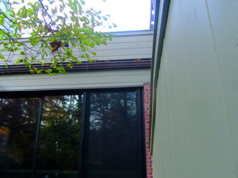

WHERE DOES THE WATER FLOW?

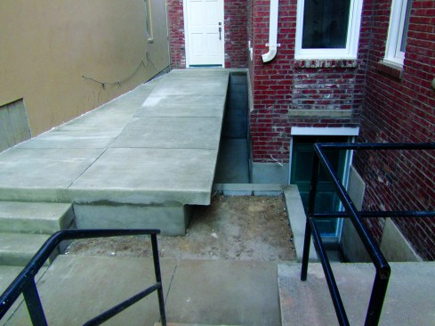

Once you have enabled a roof to shed water, one last thing you should pay attention to is where all that water is going. You need to ask what will happen if there is a torrential downpour that sends hundreds of gallons over the roof edge. In our area, it’s likely to be a summer thunderstorm that brings down enough leaves to clog the gutters, causing the bulk of that water to spill over the edge. What’s below?
You don’t want it to be a basement stairwell. Or the French doors leading to the master bedroom, or any door that is boxed in, making it the next low point after the drain. We had a situation like this on one job. What you see in the photo was below a long edge of the roof with nothing in between. We managed to convince the owners to add a small entryway roof that made it possible to get in and out of the basement door without being rained on. More importantly, this new roof deflected any overflow away from the basement area.
