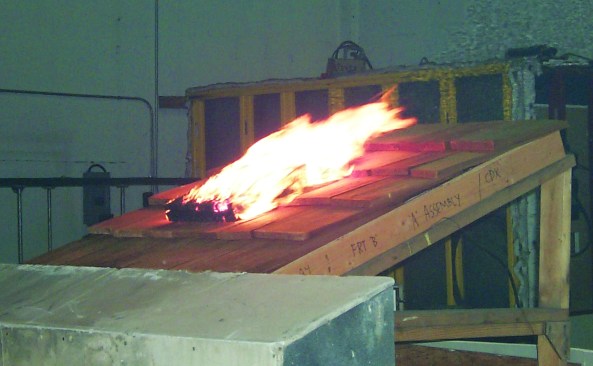

The first two parts of the ASTM test of roofing evaluate flame spread ...
The first two parts of the ASTM test of roofing evaluate flame spread …

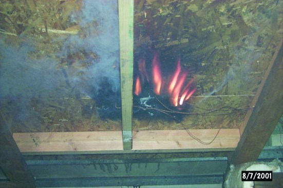

... and penetration of the roofing assembly.
… and penetration of the roofing assembly.

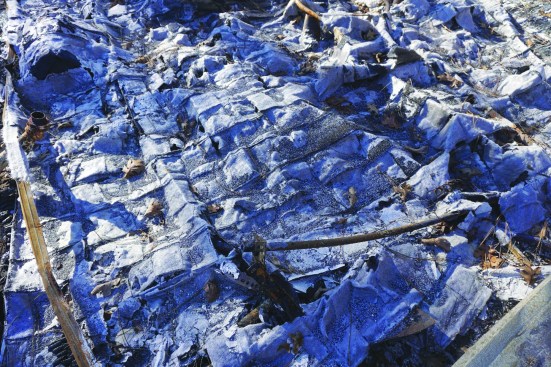

These roofing remains are from a home destroyed in the Camp Fire.

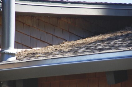

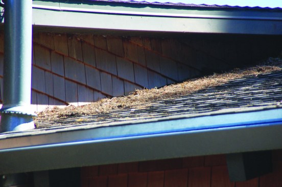

Debris piled up where combustible siding meets a roof can make a home vulnerable to wildfire.
The Class A rating is specified in the ASTM Standard Test Method E-108, which evaluates the fire rating of a roof covering and has three parts. The first part evaluates flame spread over the roofing material. The second part evaluates the ability of a roof covering to resist flames on top of the covering from burning through it and other components (such as sheathing and underlayment) in the roof assembly and entering into what would be your attic or ceiling space. The final part of the test evaluates the roof covering’s ability to resist generating embers, also known as firebrands, that can become airborne and spread a fire. With asphalt shingles, there are combustible components (namely the asphalt), but the noncombustible components (fiberglass and granules) provide the performance sufficient to comply with the provisions of the test.
It is important to point out that this test specifically evaluates the roofing material and does not evaluate the vulnerability of the roof where it intersects with other surfaces or materials, such as where a roof plane meets a wall above, or at the eaves where the roof meets the gutter. In these cases, the adjoining surface could be the vulnerable component of the roof system.
