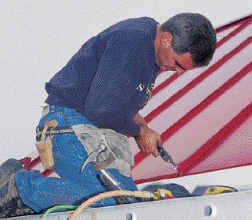

Ridges or flats? The panels are fastened to the deck or purlins with special-purpose nails or screws equipped with neoprene or EPDM washers, which compress beneath the fastener head to seal the puncture left by the shank. Nails — the fastener of choice in the days before reliable battery-powered screw guns and still used in some areas — should always be driven through the raised ridges between flats. Most roofs today, however, are fastened with screws, and while many installers also run screws through the ridges, manufacturers advise against it. Screws have lower shear strength than nails, which makes them vulnerable to breakage when they’re left sticking out far enough to clear the ribs, and adequately tightening screws without crushing the ridge takes a delicate touch (Figure 2).
Figure 2.Many installers put screws in the ribs even though manufacturers discourage it. The practice is a holdover from when the dominant fasteners were nails. Using screws and installing them in the flat sections of the panel is considered a better practice by manufacturers, because of screws’ lower shear strength and better sealing compared to nails.
While it may seem counterintuitive to those used to fastening with nails, screws should be driven into the flats, at the spacing specified by the manufacturer.
Because each screw hole represents a potential leak, it’s worth taking the time to do this part of the job right. Frank Farmer of American Roofs in Flushing, Mich., frequently sees problems with screws from improper installation. “Installers run them in at an angle, or they don’t tighten them enough so the washers don’t seal correctly — and small leaks can eventually rot the sheathing,” he says. Troy Thomas of Fabral, one of North America’s largest metal roofing producers, notes that choosing screws with EPDM washers, rather than lower-cost neoprene, will reduce the possibility of leaks at fasteners.
