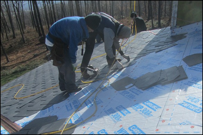

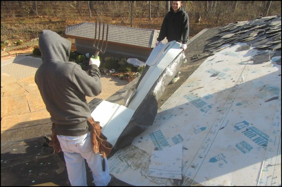

Faux slate quirks. These slates often have some surprising requirements. We once had to tear off an entire 30-square roof because the material was not approved for slopes under 6:12 without an ice-dam membrane underlayment, and it was leaking in hundreds of spots. Contributing to the problem, water had collected in large depressions molded in the shingles to designate the nailing areas and had leaked through the nail holes, causing the roof deck to swell in numerous locations. We tried to salvage the synthetic slates, but they were too brittle. (The roof had been installed by another contractor, but it was heartbreaking to see the waste involved. That product has since been discontinued.) We installed new EcoStar synthetic slates over a Carlisle ice barrier membrane underlayment rated for high temperatures.
Here, a 5:12-slope synthetic slate roof that had been inappropriately installed over regular roof underlayment needed to be torn off (the manufacturer’s instructions called for full-coverage ice barrier membrane underlayment for slopes under 6:12).
Compounding problems, water had collected in depressions molded in the shingles to designate the nailing areas.

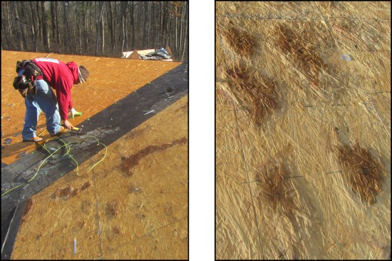

Water had leaked down through the nail holes, causing the roof deck to swell in numerous locations.

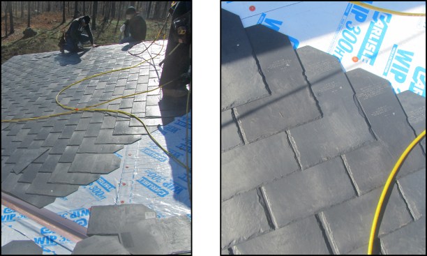

The author’s company installed new synthetic slates with proper shingle exposure over an ice barrier membrane underlayment.

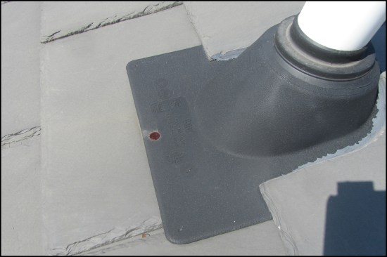

I too often encounter 10- to 15-year products, such as plastic vent boots and electro-galvanized nails, on these “50-year” roofs. Not every client wants to pay for high-quality accessories, but we price them as the default so the whole roof lasts as long as the shingles. We have struggled to find long-lasting accessories for some applications, though. In some cases, our roofers have fabricated copper covers; in others, we do the best we can. After all, a dryer vent cover can easily be replaced after 20 years if it rusts out; I feel more strongly about providing long-lasting nails and flashings.
A 15-year plastic boot with a neoprene collar is installed on a “50-year” synthetic slate roof. A heavy-gauge metal flashing sleeve and cap is more appropriate for the life span of the roof.

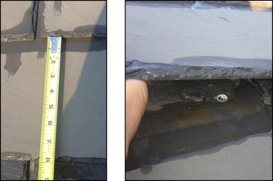

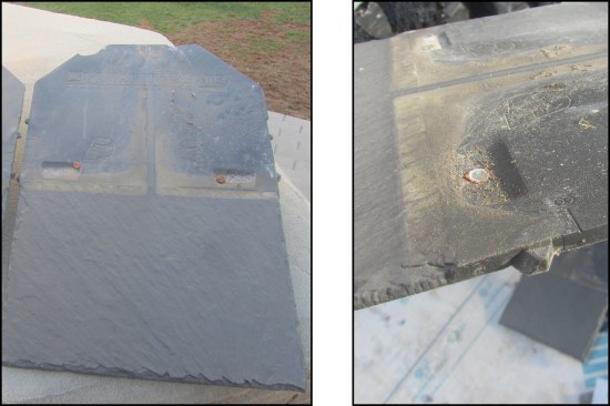

Headlap and shingle exposure. Headlap is the amount the second row above a shingle overlaps the top of that shingle (in other words, the area of double coverage between slates). For true slate shingles, code (R905.6.5) requires a 2- to 4-inch headlap depending on roof slope (4 inches for 4:12 to 8:12 slopes, 3 inches for 8:12 to 20:12 roofs, and 2 inches for steeper ones), but for synthetic slate, code gives precedence to the manufacturer’s instructions. Most of the instructions I’ve seen don’t call out a headlap; rather, they specify the exposure, or how much of the shingle is showing below the row above. But since the shingles are all the same length, it adds up to the same result: There’s a minimum required overlap, which sometimes varies with the slope of the roof. Installing slate without the correct overlap can allow water to wick under the shingles and corrode fasteners, particularly on lower-pitched roofs.
Installing slate without the correct overlap (left) can allow water to wick under the shingles and corrode fasteners, particularly on low-pitched roofs (right). Also, long-lasting fasteners should be used; electro-galvanized nails corrode quickly if they stay wet.

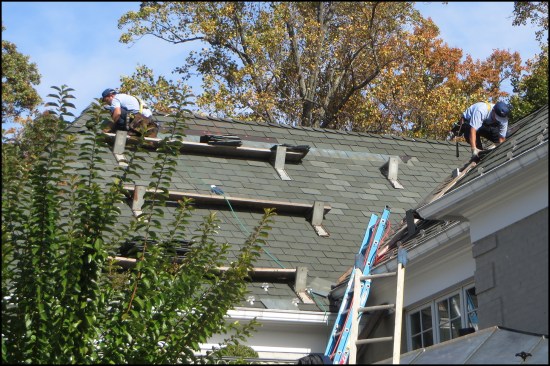

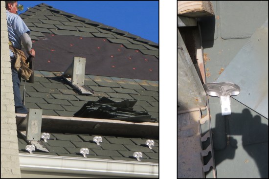

Snow guards. Slate roofs shed snow readily and snow guards are needed to protect the roof, gutters, and things below from avalanches. Synthetic slates seem to be even slipperier than some genuine slates, so guards are important. Designing guards is an entire practice unto itself, so I appreciate when manufacturers call out in their manuals how many are required, based on the pitch of the roof and how long each slope is from eaves to ridge. These directions seem to have disappeared from the instructions I recently checked, but we’ve also found that manufacturers and distributors of snow guards will usually help with the design.
Most clients love the look of the snow guards. With synthetic shingles, we’ve found that individually mounted snow guards manufactured by Berger Snow Guard Systems have worked the best. They have slim, sheet-metal legs that don’t lift the shingles up very high and that install more easily than the heavy bars on some traditional guards. They’re available in galvanized, stainless steel, or copper.
Snow guards with slim, sheet-metal legs are easier to install than traditional guards with heavy bars. Here, the individual stainless steel snow guards do not lift the shingles high (left, right).

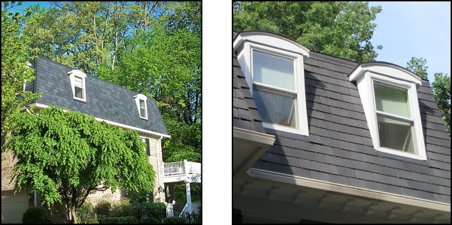

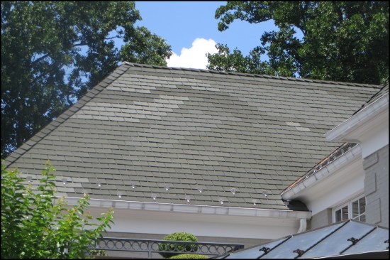

Mixing the slates. Some brands of synthetic shingles will change color after installation, and different batches will change differently. We found this out on our first synthetic install. We followed the directions to “thoroughly mix” the bundles of plastic shingles, even though they all looked to be the same color. Within a few years, the roof had a noticeable variation between slates. In a way, it looked more natural after the color change, like a genuine slate roof with different shades.
On a 10-year-old EcoStar slate installation, slates were mixed from different bundles per the manufacturer’s instructions. Although the slates all looked the same upon installation, the color varied over time, appearing more natural (left, right).
On another project, our roofer was not careful with the mixing, and the roof looked pretty odd after 10 years. The shingles were still in great shape, but the colors looked bad enough that our clients made a reasonable request that we fix them. We had a crew carefully remove, mix, and reinstall the shingles over new underlayment—lesson learned. Now when I drive around town, I notice this issue everywhere, regardless of the synthetic slate brand, color selection, or roof pitch.
On another project, the author’s roofer was not careful with mixing the bundles, and the roof looked odd after 10 years.
Per the client’s request, the shingles were carefully removed, mixed, and reinstalled over new underlayment.
Click to enlarge

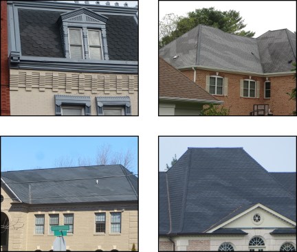

In the author’s region, inadequately mixed or blended shingles are common regardless of synthetic slate brand, color selection, or roof pitch (examples shown above). Some manufacturers have recently started premixing bundles of slate to help with this problem.

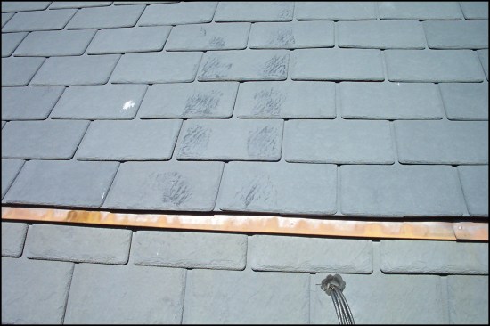

Oxidation. The top surface of some brands tends to oxidize, and I’ve seen this oxidized layer rubbed off by maintenance workers’ boots numerous times over the years. It’s best to avoid repeated travel on most types of roofing, so provide direct access to HVAC equipment or skylights that are located on upper roofs and may need regular maintenance (although keeping equipment off upper roofs is the optimal solution). Some flat roofing materials have walking pads you can add, but I don’t know of any for steep roofing.
The top surface of some brands tends to oxidize. Here, workers had rubbed off the top oxidized layer with their shoes when maintaining a skylight on an upper roof. These wear marks can be quite noticeable from the ground.
