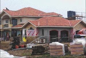

by Charles Wardell After hurricanes Frances, Charley, and Ivan blew through Florida in 2004, the Federal Emergency Management Agency (FEMA) sent teams to survey damaged homes and buildings. One of the most common problems the teams found was failure of the roofing system. Although the investigators saw failures with all roofing types, the tile industry was the first to respond with new design criteria and installation details. These details have since been added to the Florida Building Code, and more code requirements are under discussion.

But some roofers continued to use mortar. Tim Reinhold with the Tampa-based Institute for Business and Home Safety reports that his organization had supported a code-mandated ban on mortar-set tiles in high-wind areas, but he notes that opposition by roof installers was too strong. As a compromise, the industry came out with a code-approved prebagged mortar with just the right amount of sand and cement.
The 2004 FEMA investigation underlined the weakness of mortar set. Tom Smith of TLS Consulting in Rockton, Ill., who served on the FEMA survey teams, says that the size of the blow-off area of mortar-set systems typically was much greater than for tiles attached with foam or mechanical fasteners. He advises against mortar set, no matter what type of mix the roofer uses. FEMA's Home Builder's Guide to Coastal Construction (http://www.fema.gov/rebuild/mat/mat_fema499.shtm), published in June 2005, also recommends mechanical attachment rather than mortar set in all high-wind areas.
Other industry groups agree. For instance, Reinhold says that IBHS's Fortified … for Safer Living program, which certifies homes as disaster resistant, has never approved a mortar-set roof. "We've heard comments that tiles are so dense that it's hard to get a good bond. We recommend against it."
Mortar-set roof tiles were easily stripped from an apartment building in Punta Gorda by Hurricane Charley in 2004. To improve attachment, both mechanical fasteners, such as screws or nose clips, and adhesive foam are recommended for coastal homes.
