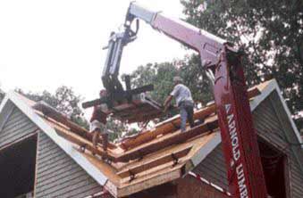

Faster on steep pitches. Top-down roofing actually saves me time on roofs with pitches greater than 8, where I typically use roof jacks. All the jacks and planks can be installed during the roof sheathing operation. This makes handling and nailing off the sheathing go faster. Plus, bundles of shingles can be spread out on the staging planks — no need to attach cleats to hold the shingles in place. I spread one bundle per sheathing panel for three bundle-to-the-square shingles. A boom truck or shingle conveyor makes short work of this task.
After staging is in place, shingles are boomed up and spread on the planks.

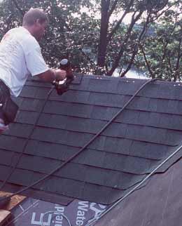

With top-down roofing, it's especially important to mark horizontal control lines so you end up with a standard 5-inch exposure at the bottom. I determine the horizontal layout by tacking a full shingle along the eaves, letting it overhang the drip-edge the standard 1/2 to 3/4 inch. (You could just measure from the drip-edge and make the adjustment for the shingle height and overhang, but I tend to make math errors, so I like laying out with an actual shingle.) Then, working from the top plank and holding my tape measure against the top of the tacked shingle, I mark down the roof along the rake in 5-inch increments (5 3/8 inches for metric shingles), starting at the ridge. I do the same at the opposite end of the roof, then snap chalk lines between the marks. I don't snap every course; lines at four- to six-course intervals (20 to 30 inches) are frequent enough to keep course drift in check.
Working from a carefully placed starter shingle, a carpenter snaps control lines in 5-inch increments starting from the top of the roof.
