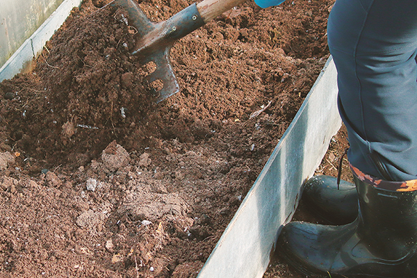

If the soil does contain high lead levels, there are ways to reduce the risk so that the space can be used for gardening. For example, the homeowners can amend the soil with lime and organic matter to immobilize the lead, or simply make raised beds with clean soil. If they decide not to garden there, covering the soil with sod will protect children who might be playing in the area. There's a much higher risk of lead exposure through direct ingestion of contaminated soil than there is through eating plants grown in the soil.
