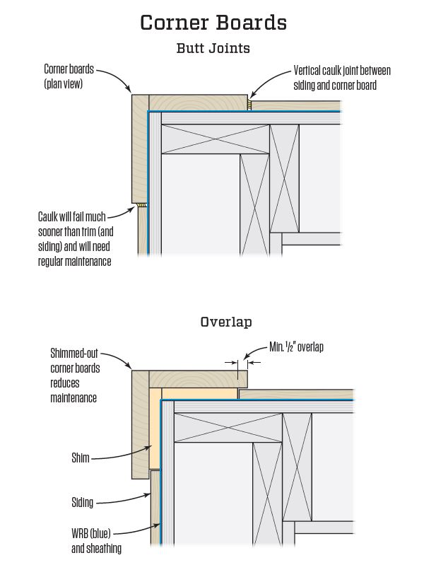

Q: We have been installing fiber-cement siding, which seems to hold paint much better than wood sidings near the ocean. However, the ends of each plank must be held off the corner boards by a quarter of an inch and caulked. After a year or two, the caulk cracks and shrinks back, and generally looks terrible, defeating the purpose of a durable siding material. How have others dealt with this problem?
A: If you flash behind the corners, either with continuous lengths of double-thickness black paper or metal L-flashing, you shouldn’t need to caulk the vertical seams at all. However, homeowners don’t always like the look of this. It’s not very noticeable on inside corners, but at outside corners it looks like you cut all the siding short. So, for outside corners, it’s common practice to lap the seam with the downboard — by packing out an outside corner with 1x stock to match the lapped siding thickness, as shown in the illustration above. Theoretically, you can rabbet 5/4 stock, as well, but in practice, the overlapping leg of the rabbet isn’t very thick and can easily curl and crack.
Another alternative is to use a PVC corner post made for this purpose by Tamlyn & Sons (800-334-1676; www.tamlyn.com). Tamlyn makes a variety of styles of corner posts for both inside and outside corners: one type provides a channel to accept the siding ends and another type automatically flashes behind the seam so the caulk can be left out entirely. This PVC is much more durable than ordinary vinyl cornerposts and can be painted to match the siding. However, when you get right up to it, there’s no masking the fact that it’s plastic.
CORNER TREATMENT FOR FIBER-CEMENT SIDING
Corner boards shimmed out to overlap the ends of fiber-cement siding will last longer than a vertical caulk joint. (Illustration by Rick Vitullo)
